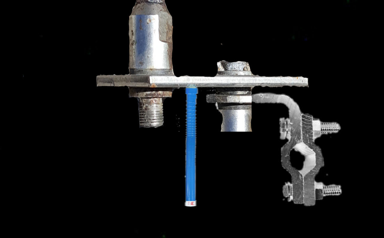

    it is highly doubtful. that extension bracket needs to be isolated from the feed point so it does not make an electrical connection to the shield of your coaxial cable just like I described in this picture.
    a 3-foot Firestik should work just fine as a counterpoise as long as you do not exceed the wattage rating for that particular antenna
