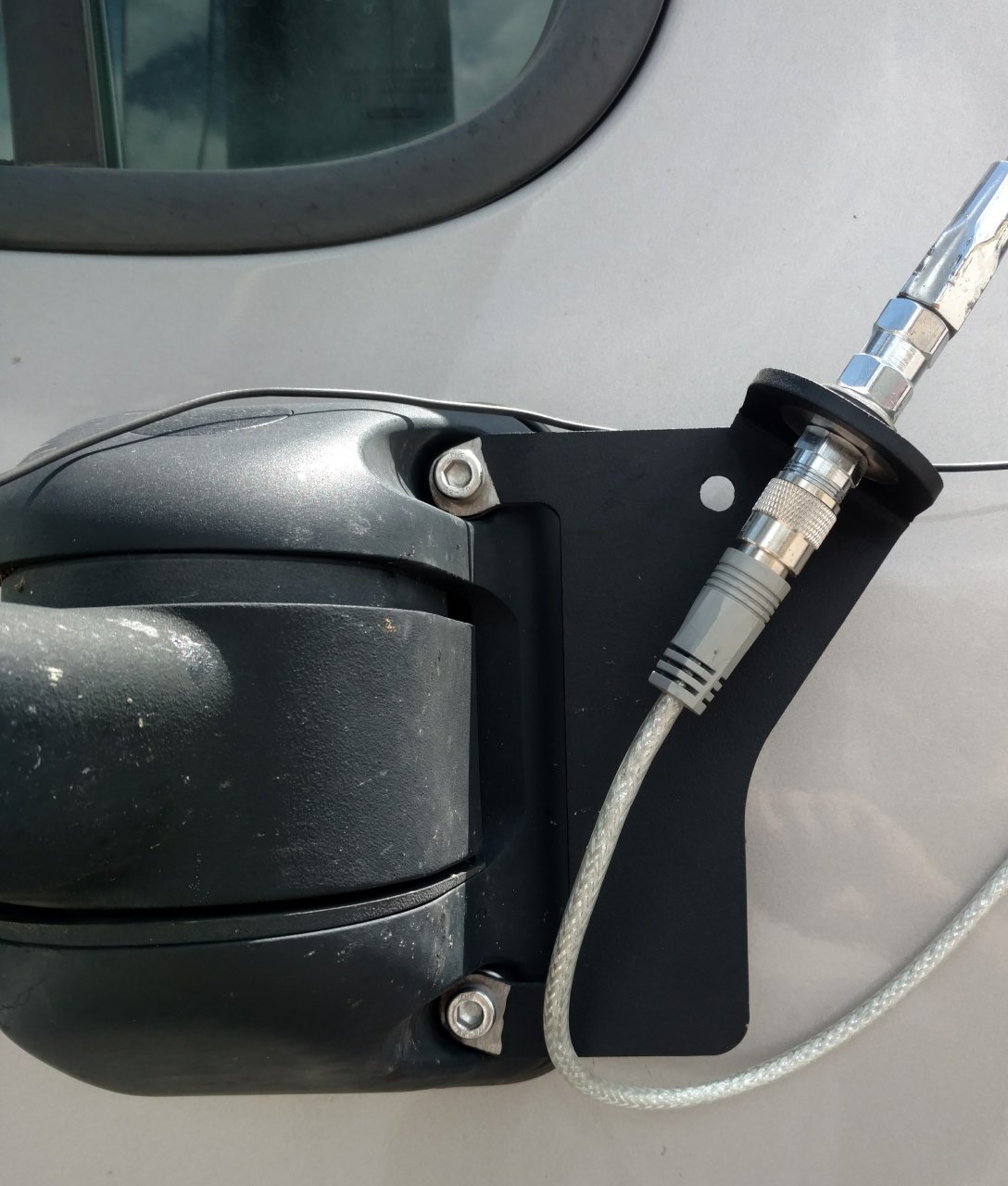

    IMG_20170723_152512.jpg IMG_20170723_152512.jpg IMG_20170723_152512.jpg IMG_20170723_152512.jpg IMG_20170723_152512.jpg What does everyone think about this cascadia mirror mount?

    Sorry about all the thumbnails, learning this uploading pics deal. Done it with my camera off my mirror mount. Driver's side or passanger side, heavy Steel $39.99

    Looks sturdy and gotta luv the built in 20ish deg angle..
    Where did you buy it..Is it cheap steel or painted stainless?

    Skellr..You think thats a 45 deg???? Hard to tell by the pic BUT remember @ speed a fibreglass ant will pretty much straighten up to..Even the whip on some of the ext coil ant will bend some twards the 90 deg(vertical)

    Fiberglass antenna seems to break off at the base faster when they are angled that far forward. At least the 4.5'-5' ones do.

    Use heat shrink @ the base or some pvc pipe to sturdy it up..Thats what i did with my 7ft skip shooter

    Actually it is 30° which still might be a little much, but the antenna is vertical running down the road....and it is heavy steel, not gonna give whatsoever.

    Craig it is heavy steel, this won't bend. I picked it up at Clay's radio shop San Antonio Texas. You can get driver's side or passenger side $39.99..I mentioned to them about the degrees of the antenna mount hole, and they was aware of the degrees..said if you use a coil could it gets it way in front of windshield...well it does just that.got a 13 inch riser under the coil, and swrs 1.5 across the channels.
