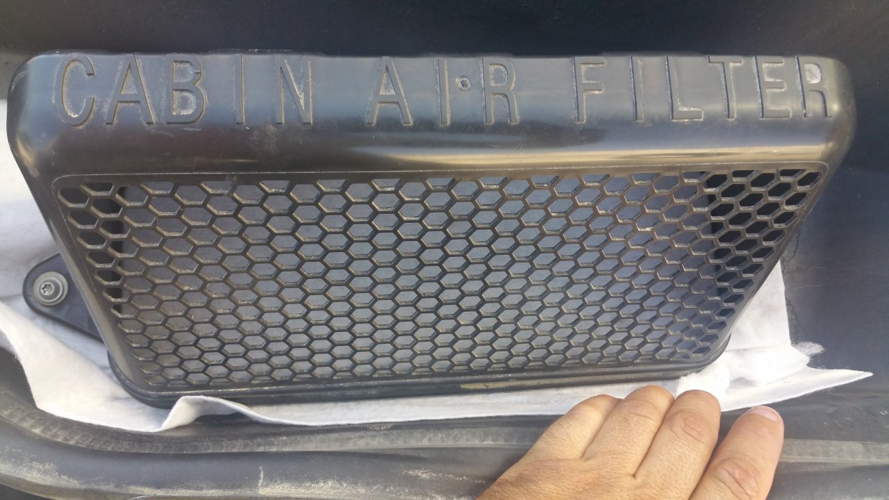

    I work in some very dusty conditions. Does freightliner make like a sock to put over the cabin air filter assembly? The picture doesnt do the dusty conditions justice. Getting old replacing air filters. Thanks

    home depot has 3 layers filters. buy it, cut it and put in front of this manifold.

    That's the one I use loading grain.
    Just wash it out once a month.

    Gonna try this and see how it works out.

    I have the Cascadia pre-filter set up. Works well for me. I have bad allergies, I also stay on top of the filter that sits under the PAX side kick panel (in the blind) filter on the inside of the cab. People tend to forget or remove that filter. I also change out the filter for the A/C unit in the sleeping area. Really keeps the dust out - it helps too that I am always air blowing the the inside of the cab to mitigate the dust issue.
