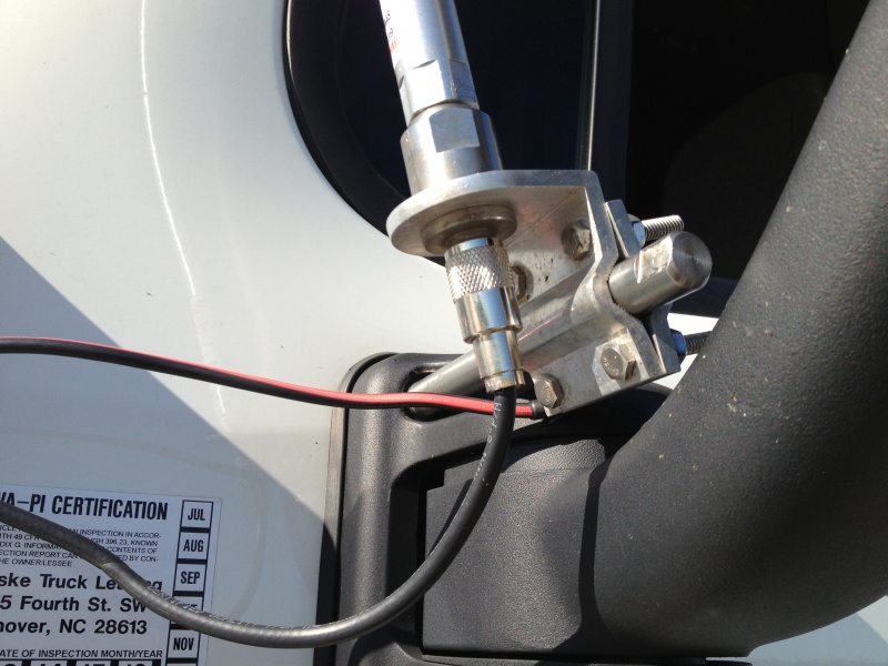

    Mounted my AR-3500 right to the dash with 3M doubled sided body side molding tape. When you take it out it doesn't leave any residue or markings on the dash. I ran my power directly under the hood in front of the clutch pedal on the firewall. Ran the power cord and coax out the of the driver side wall right behind the signal light. Takes about an hour to do it but no holes drilled and will completely be in stock shape when you get out of the truck. photo 2.JPG image.jpg image.jpg
