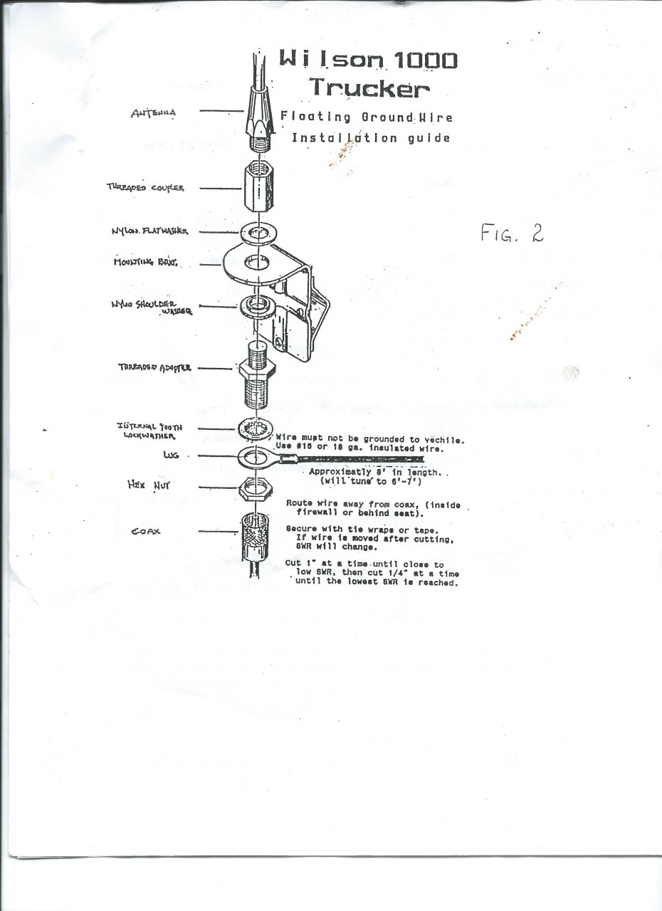

    This is part of the RF tuned ground I talk about but it isn't a counterpoise, because truthfully counterpoise is the wrong term to use.

    What should i expect to see,how will i know if it works...
    As per the diagram it tunes around 6-7 feet....How do i tune a wire attached to the coax connection...
    Dont see how i can route that wire away from my coax seeing im trying the dipole idea on the 40" tall cascadia door mount..
    Speakin of the dipole,if i need to tune the ground antenna 1st i can do but if memory is right my 5.5 ft firestick was to short electrically..So it wouldnt tune fully,close but not like my 10k does..

    Do you have any idea how much wire is in your five and a half foot fire stick?
