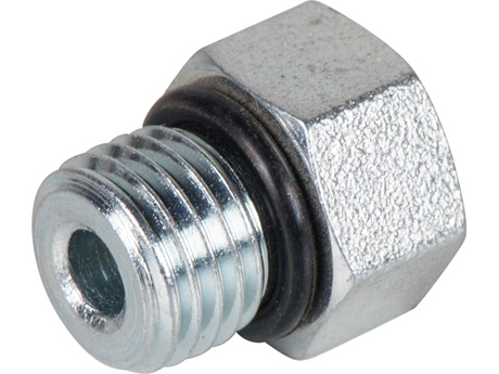

  9. AModelCat
    29,759
    165,353
    Looks like a #4 or #6 ORB fitting. Probably could have picked up one with a hex or allen head for like $3

  11. 77fib77
    77fib77 Road Train Member
    11,798
    78,198
    Jul 7, 2010
    St Louis
    Yeah I know. Home Depot. Probably 8 bucks with Teflon tape.
