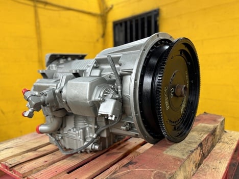

    The allison adapter looked like this
    The inner holes bolted to the flywheel, the outer one were for the torque converter

  9. Gurbaz601
    Gurbaz601 Bobtail Member
    15
    2
    Feb 10, 2018
    This look similar to what i have maybe md3060 tranny IMG_5907.jpeg IMG_5909.png
  10. Star Rider
    Star Rider Road Train Member
    1,796
    18,957
    Sep 23, 2019
    Michigan
    I got it backwards, it's been quite a few years.
    I really don't remember seeing those tabs though.
    Big Road Skateboard Thanks this.
