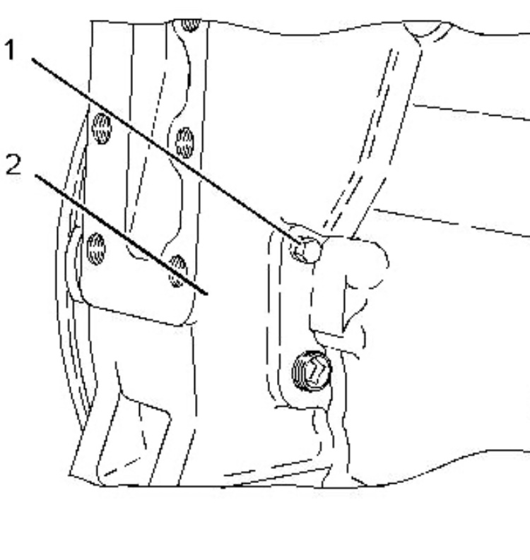

    got home later today, rolled engine over and pinned pump, ran out of daylight, will go out first thing in am, but my question is where exactly is the timing hole on bellhousing? i am looking on the turbo side, there is a pipe plug there im thinking remove that? or there is an open hole just above it that is open mabe 1/2 inch hole, the pipe plug is mabe an inch or so big and half inch drive to remove, i should of took a pic but didn't, tryin to refrence the hole on internet with not much luck

    im thinking it that smaller hole? number 1 in pic not the larger pipe plug
