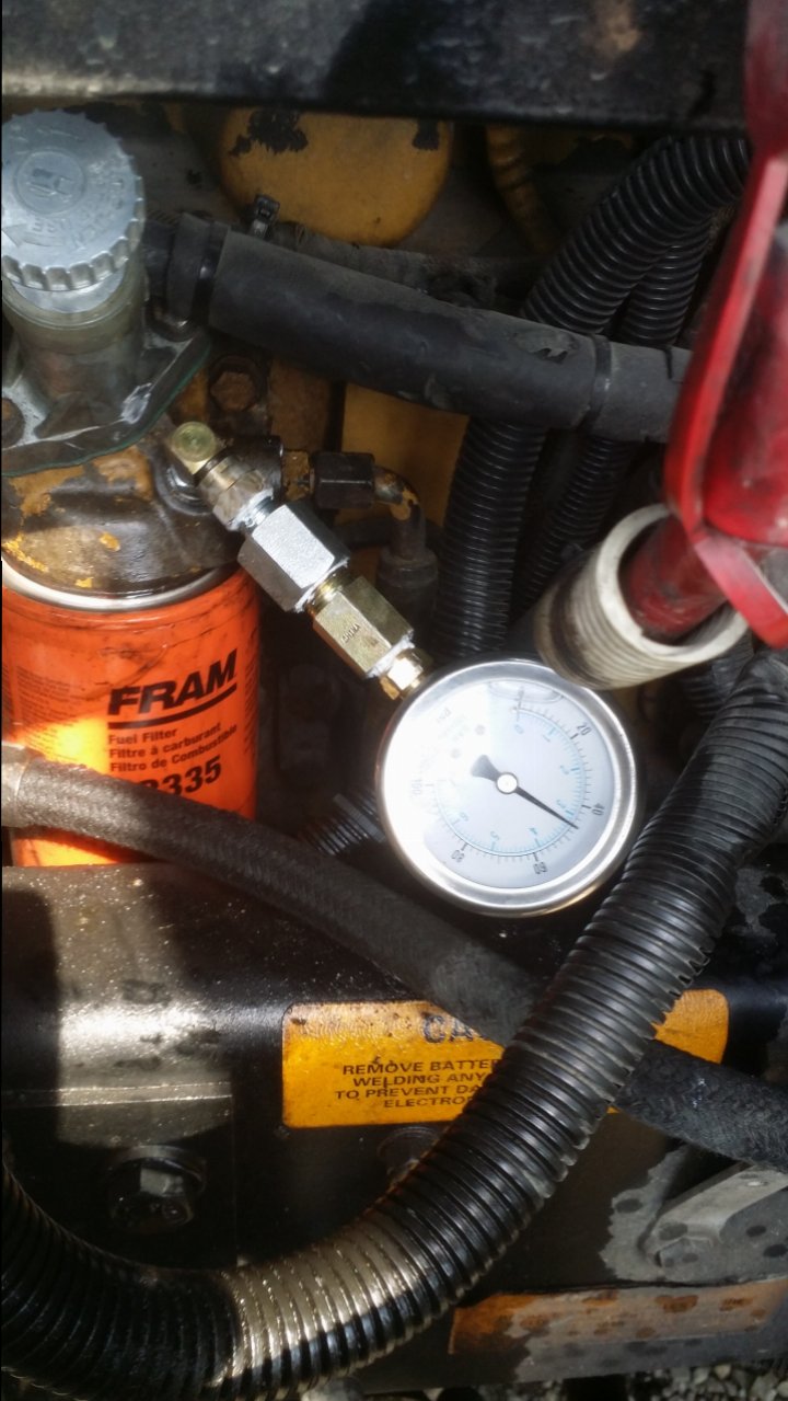

    20150905_114540.jpg Ok tested fuel pressure getting about 50psi at idle and 80psi at 2100.
    Only specs I see on this say 65 idle and 90-95 2100

    when you shut off the engine does the gauge show it holding pressure for a while?(1 or 2 minutes) if not the check valve is weak or they pinched an o-ring when they installed the injectors.

    Yeah holds above 20psi for over 5 min.

    mine doesn't hold pressure at all, a friend of mine can shut his go to lunch and then turn the key on and it still holding 50 psi.
