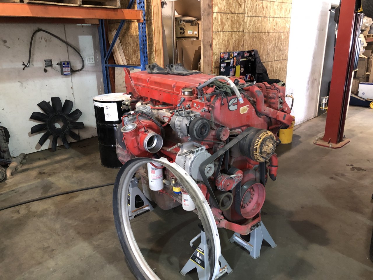

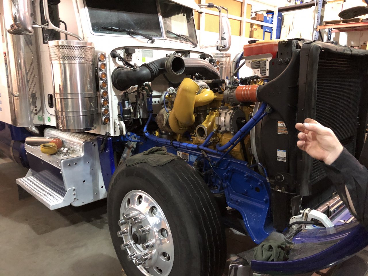

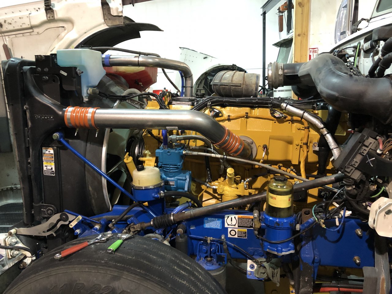

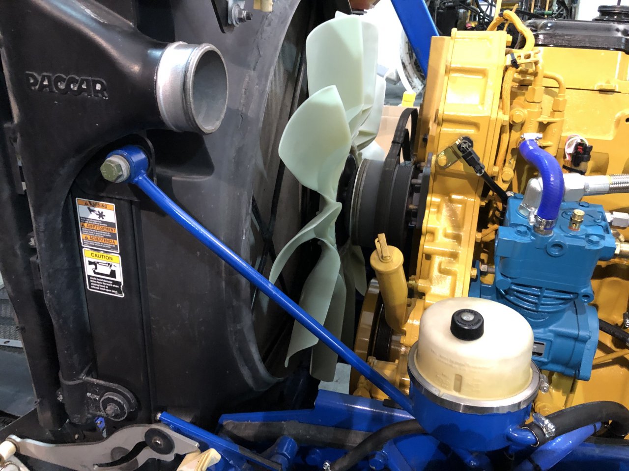

    8B9445DE-A7E3-4041-BA83-8D5922A93304.jpeg D3513294-E582-4878-9DE3-26F123161189.jpeg B7922AAD-ACA9-4E55-980E-1B525AC45180.jpeg 2ED34D5D-1A91-4A9D-BF96-44AD7ABD17E9.jpeg I guess I’m going to prison then. Rather do that than be bound to new emissions bs. I left my 2013 engine on the shop floor!
