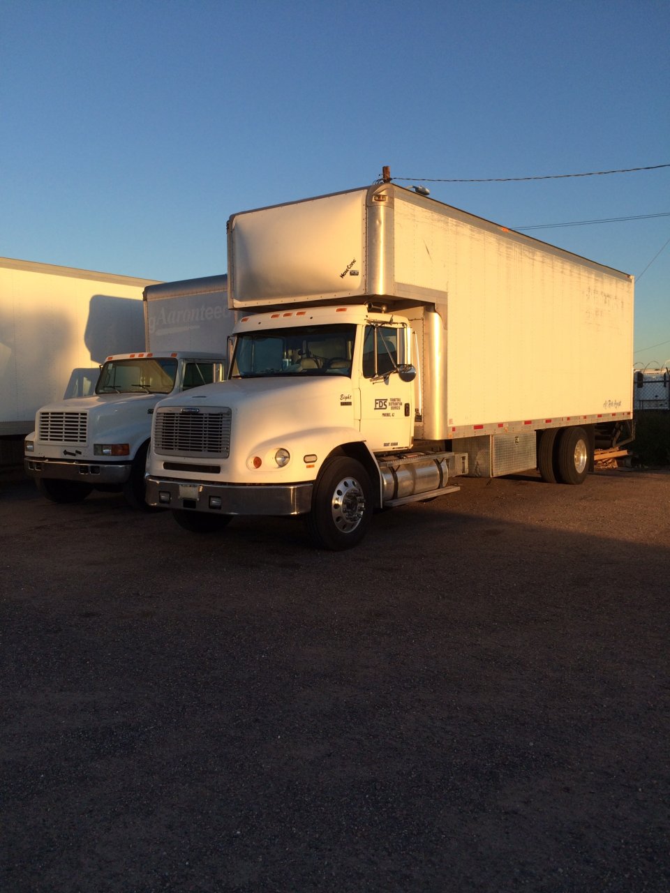

    I have a C10 in this furniture truck, 300hp w/Allison 6 sod, this thing is a race car-not sure how it would be pulling the kind of weight you do.
    I would hold out for a bigger engine.
