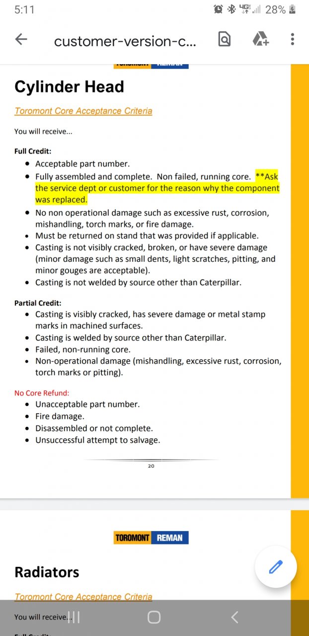

    Never heard of still getting full a core credit on a cracked head.... When a head cracks because of heat it is usually the casing that cracks Screenshot_20200701-171116_Drive.jpg Screenshot_20200701-171116_Drive.jpg

    I have an American Premium Castings aftermarket head on my truck .... lots of em going strong out there.
    No Core
    bad-luck Thanks this.

    All i can tell you is from first hand personal experience with cracked heads I have always gotten full core credit
    BoxCarKidd, pushbroom and bad-luck Thank this.

    I am GLAD you did! My friend was not so lucky

    I have done the same: Received core credit on a cracked head. Failure happen while the vehicle was in operation. No junk yard stuff.
