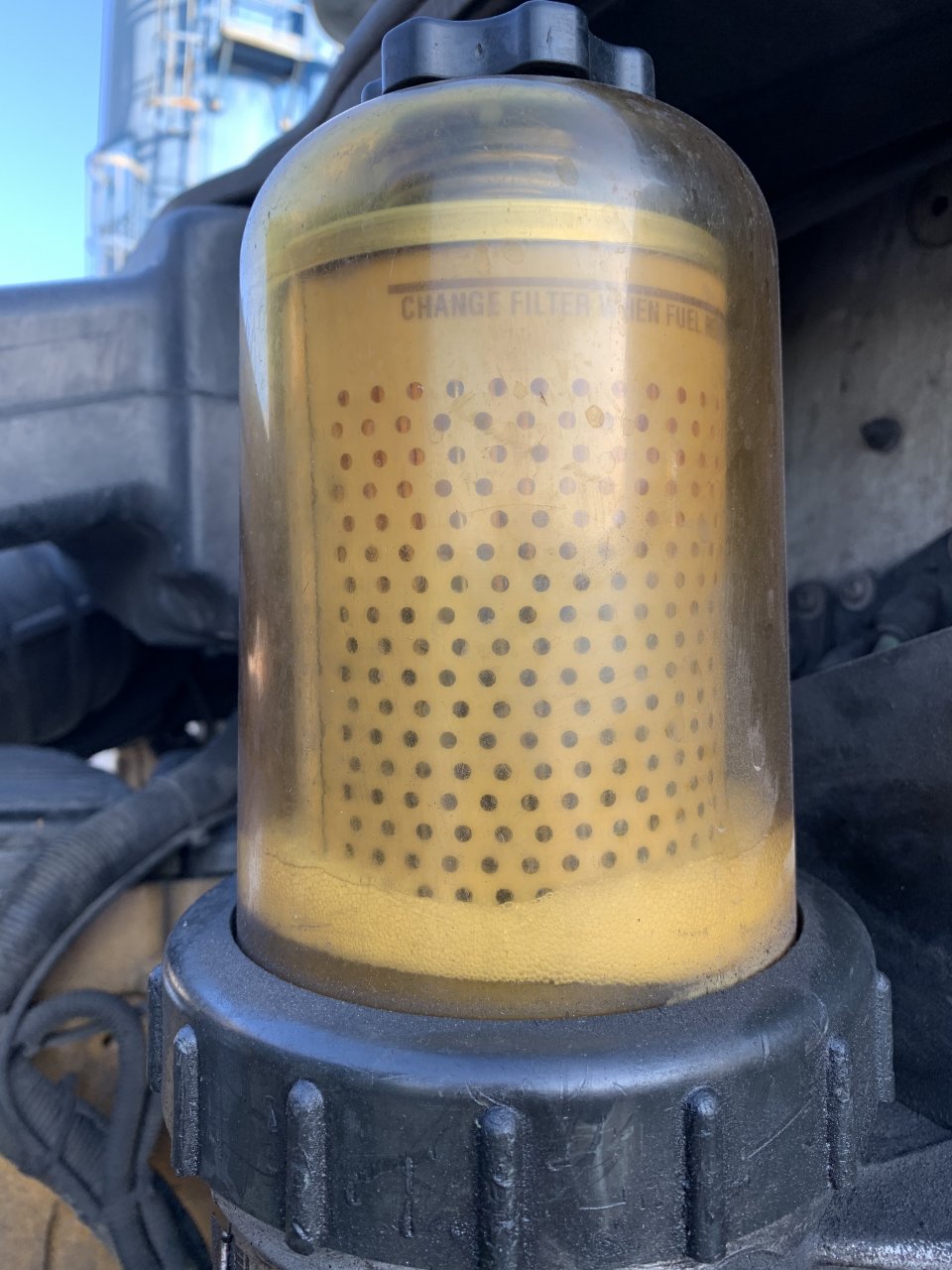

I’m getting mad lol, Ok guys the primary stays filled when I shut off truck. But then shortly after leaving it off for 10 minutes I go to crank it’s still doing it. I checked filter housing all good no cracks. Fuel lines all good. Replaced fuel pump all good on that. Replaced check and return valves all good. Need help!
Like 10 minutes of setting this effer on fire lmao
I’m seeing a lot of bubbles when on
