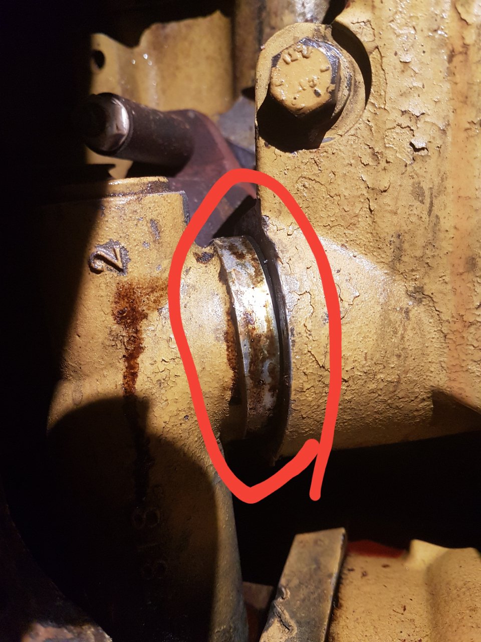

    BF202466-7CA9-4981-AFF8-93A8583CF57A.jpeg Did you fix this leak? Something doesn’t look lined up right. It looks ####eyed in the housing.

    Not yet, I think I'll bring that back to the mechanic who just did the water pump and let him fix that one. It was doing this before he did the water pump and it was sealed good at that point So I don't believe that's my issue.
