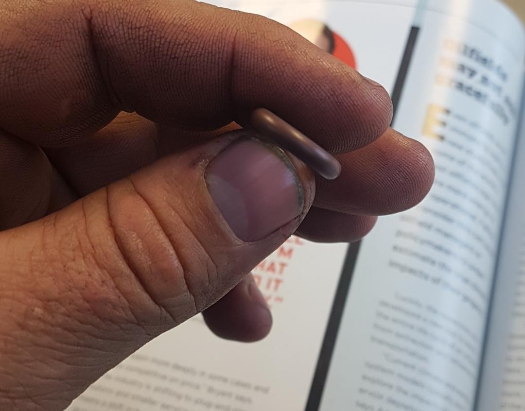

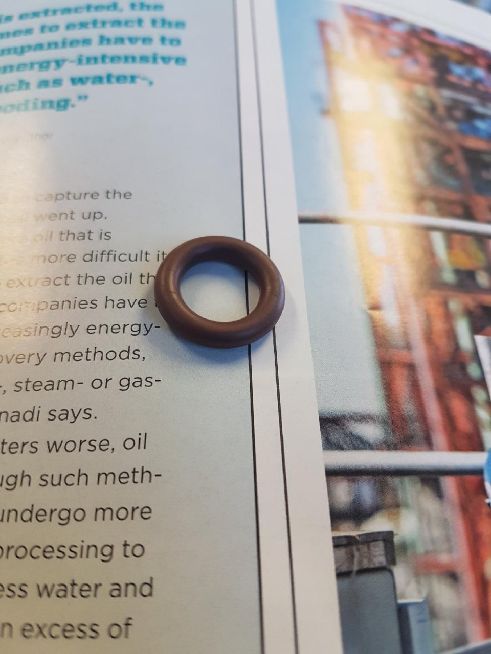

    I forgot about this..... the shop who did the water pump had found this in the old water pump cavity.
  4. pushbroom
    pushbroom Road Train Member
    1,791
    7,403
    Sep 1, 2012
    Probably from the last engine build. Things happen, sometimes orings get dropped and bounce away. If the engine isn't taped up perfect it can end up inside. Shouldn't be related to what you got going on right now.
