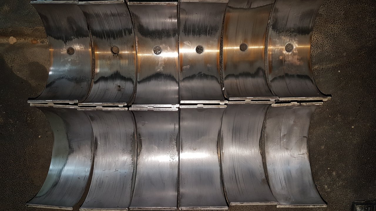

    Top are the connecting rod side
    Bottom is the cap side
    Left to right cyl 1,2,3,4,5,6
    Cyl 3 cap bearing has some bad scoring on the right side..... more like a flaking camshaft, gonna go back and inspect my crank before I go any further here.
    I don't like the way these look for how little use the engine had.... 4 months work and they look beat!
    Oxbow, Tug Toy, SAR and 1 other person Thank this.
  8. Cat sdp

    You just replaced them....?

  9. dustinbrock

    Yeah, motor was rebuilt Feb 2017 but only worked like 4 months to 6 months max

  10. spsauerland

    Who tuned it? Over aggressive timing and fueling kills rod bearings.

  11. dustinbrock

    That is not the case here for sure, the truck is tuned nicely with a modest 625 crank horsepower, not like a crazy 750 or anything.... doesn't roll coal or anything. Tuned by a very reputable tuner and not one of those hack job pdi type tunes.
