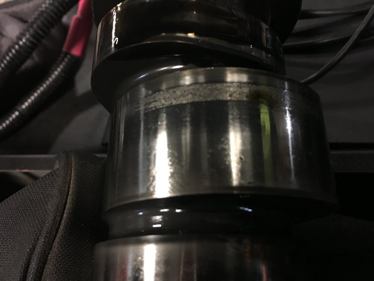

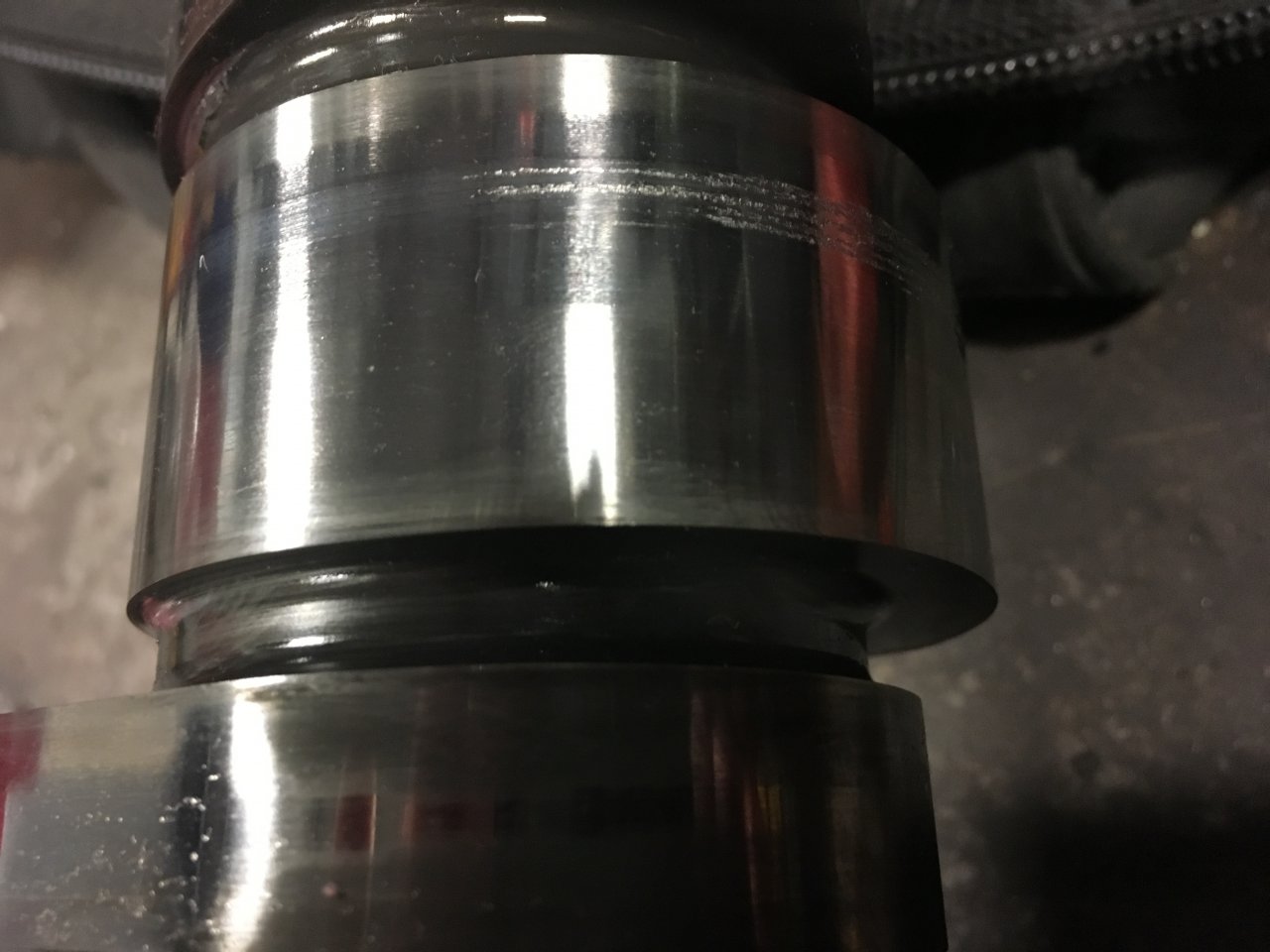

    20180625_163342.jpg it was this top seal that blew, combustion was entering was seeping between the top of the liner and the head gasket and entering via the flange area.... after shutting down the motor, I don't see how coolant could defy gravity and travel upwards into the cylinder chamber? The bottom o rings were all intact, this explains why the combustion gas tests I did failed.
    I guess if the head gasket was blown, maybe it took out a water jacket also which could have let coolant in.
    I hope that's the issue, would be a easier fix... I'll just have to measure everything real good when putting it back together to be sure.
    Oxbow and SAR Thank this.

    When you shut the engine off the pressure in cooling system is at cap spec, 16psi?? You dont think coolant wont go back into where the combustion gas got out???? Yours was really blown good too.
    Oxbow, SAR, dustinbrock and 1 other person Thank this.

    The pressurized cooling system would push coolant after you shut the engine off is what I think @swaan was referring to.
    Oxbow, SAR and dustinbrock Thank this.

    You make a good point swaan... Yeah it was blown to smitherines. I was honestly expecting more damage than I have found from pushing it as far as I did but for me... It made alot of sense to risk it.
