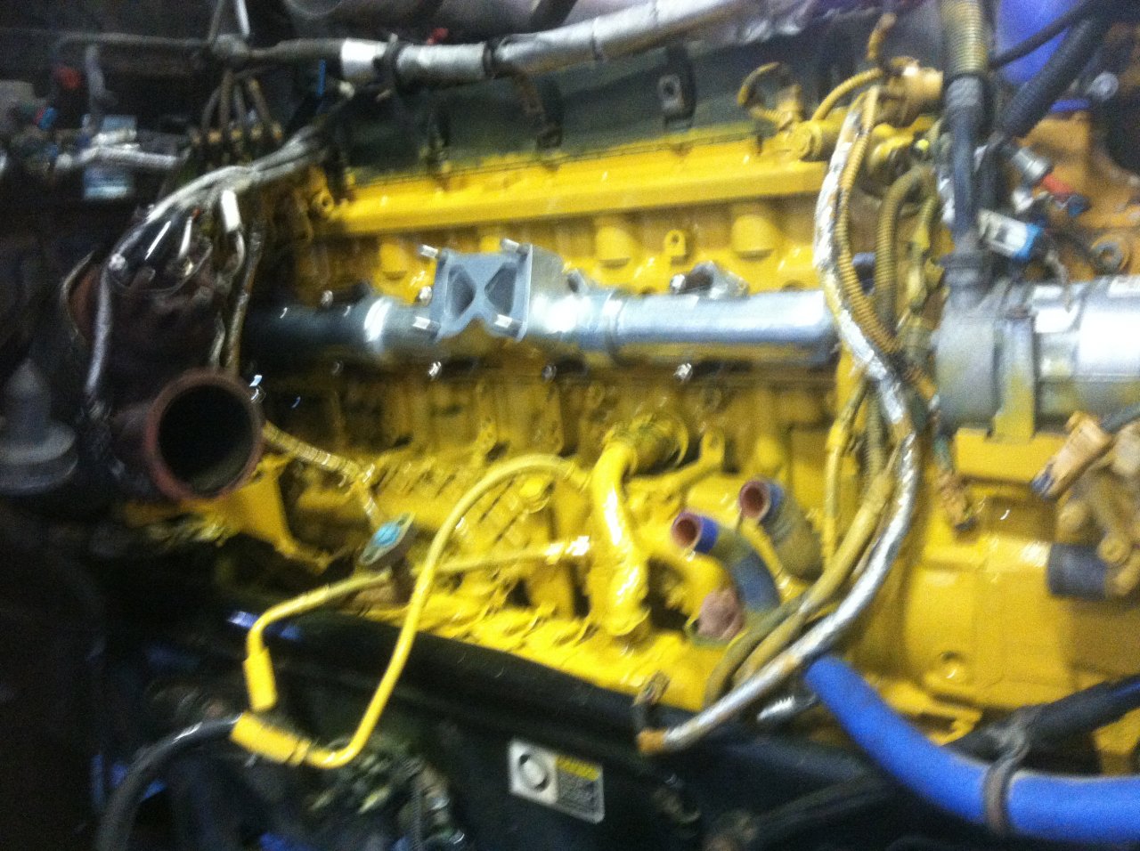

    I am, spent all winter driving other people's trucks and weighing my options. I've determined I hate 16:1 si glen turbo cats! I love the sdp engine with the ball bearing low pressure turbo when it's running good..... best responce I've ever seen. I think I'd go lower compression if going bigger power but I'm actually gonna lower mine.
    I am still on the fence as to how I want to set up the ivas, but that's all.

    The lag isn't from the 16:1 comp. It is from going to a single turbo over the twins. You can keep the twins with the low comp pistons and have as quick of response. The issue with an acert is the 18:1 pistons and the vva. lower the comp. And you WILL get a better breathing/ running engine. With the right tune a more efficient engine. You have to understand ,the vva, s bleed off the excessive cylinder pressure ( boost) caused by the 18:1 pistons. To a point.
