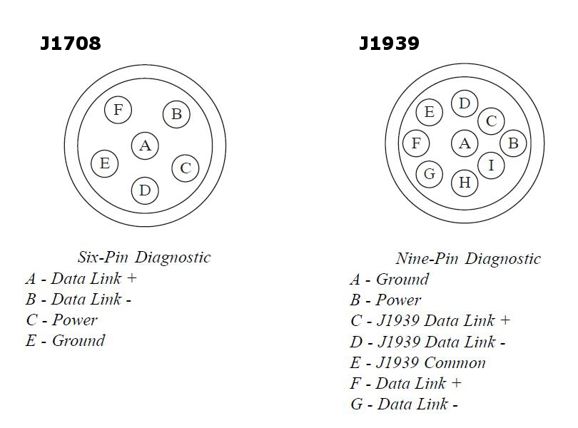

    HI I went to hook up my laptop with cat et to my truck today and its not communicating with the ECM. When I bought the truck last year the dealer had to hotwire the ecm to read it, I figured whatever they did they would of left, But they didn't just my luck. I have a constant 12.8 volts to the "B" wire so its not that wire however I have no idea where the other 3 wires in the connector go. Its a 6 pin J1939 connector and has 4 wires total in it. Its a 04 379 with a MBN C15, does anyone have a wire schematic or know where these wires go to in the ECM? Any help is appreciated. Thanks!

    An 04 should be J1708 which is 6 pin vs J1939 which is nine pin.
    Between pin c and e should be 12v.
    A and B should have continuity to the pins on the ECM.
    Post the last six of the S/n for the Pete digrams

    Cat and Pete diagrams attached. Check for power and ground first. If you have good power and ground but cannot hookup you have a datalink issue Let me know if you need help deciphering the diagrams or tracking down a circuit.
