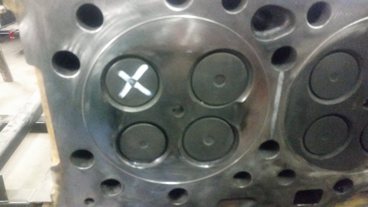

    Hello.
    Have you done receiver grooves in liners for the stainless steel fire-ring wire which in cylinder head?
    Like on this picture

    20161226_113016.jpg Yes, I had them installed in the head. I also filled in the relief cuts between the cylinders. Oh sorry I misread you'd post. No I didn't cut the grove in the liners it isn't needed.

    That is more involved and requires modification of the head gasket as it does away with the stock fire ring, the process that we mentioned only requires work on the head and is used with the stock gasket and liner.
    It is also known that with a factory cat liner machining the groove into it for the wire ring weakens them significantly and leads the the flange cracking.

    Could you tell me the height of protrusion and diameter of stainless steel O-ring wire, the depth of the grooves in the cylinder head?
    I guess 0.041" wire, and groove depth of 0.035" (0.006 above deck)?

    All I know is the ring protrudes .005 from the head.
