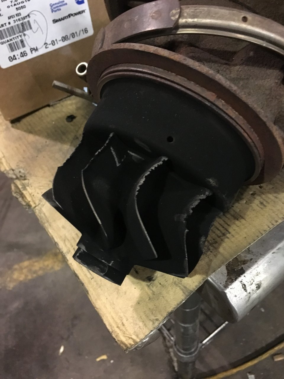

    Have you checked the turbo for any damage?
    There was a guy on here not too long ago that had engine work done and when he got it back had half the boost and no power. He was stumped also cause it ran fine before work was done to it. It turned out that whoever did the engine work didn't keep things clean and eventually dusted both turbos. I hope this isn't your case.

    SAR..... I have had 2 different mechanics inspect the turbo. Its only about a year and half old. How would they know if it was dusted and damaged? Also, They have already ordered the injectors. Trust me i have been calling them several times a day giving them all these different ideas all you guys have been giving me.

    The turbo fins will have nicks or bent blades. I will see if I can find that thread I was talking about earlier. He showed some pictures of what happened.
    The way it sounds your turbo has been checked and verified it is ok.

    It would look like this

    Wow... Well yeah that is some really extensive damage. I will ask them tomorrow if they have for sure fully inspected the turbo. I can see how that would cause a problem
