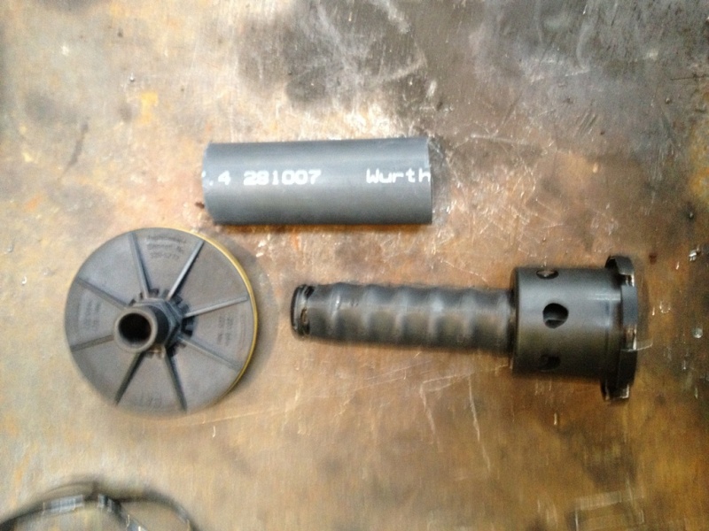

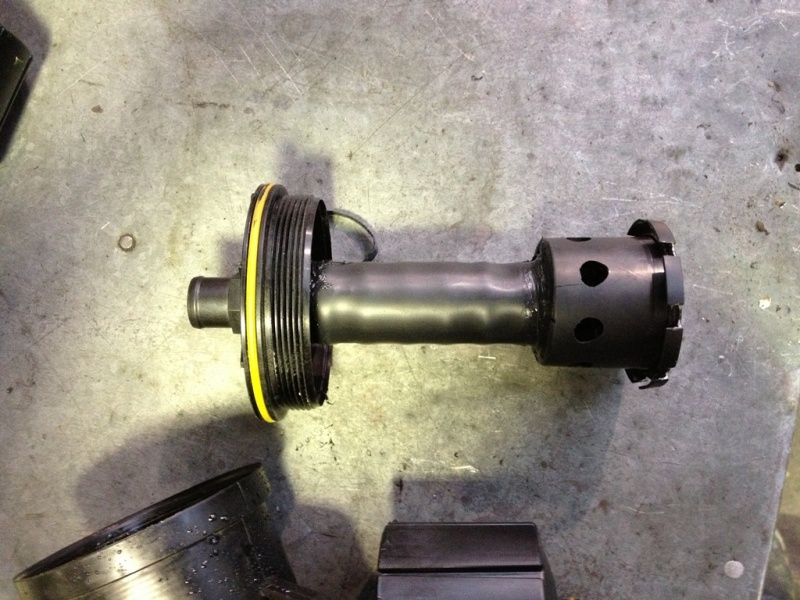

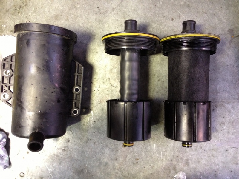

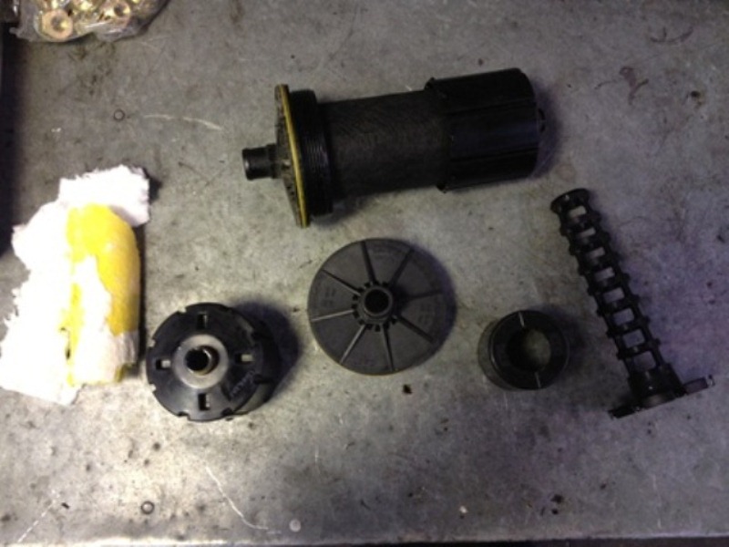

    Here are some pics of my updated occv filter
    you will see the paint can lid to deflect any oil down the correct passage back to the sump,
    the rest is simple just heat shrink,
    you will not have the crank case pressure fault unless there are other mechanical issues, also you guys running deletes where the crank case pressure sensor no longer is seen by the ecm, you will not blow turbo seals and have oil leaks on the rest of the engine due to high crank case pressure ( blocked occv filter )
