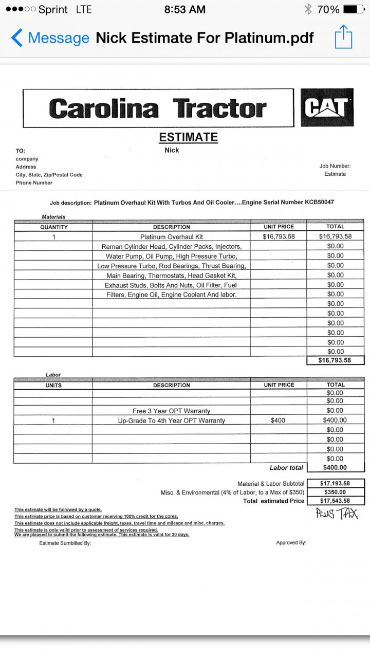

    No labor in that estimate? The only thing I see listed on labor is the warranty?
    What is a good estimate on labor? 40 hrs? 40×$115=$4600?
    I'm looking at used trucks myself. I'm just trying to get an idea of what it will cost to rebuild one when needed.

    That includes labor. After taxes it would probably be around $19,000+/-. If you're looking at trucks with a CAT motor you can figure on about $25,000 for an inframe, that would be plus extras not included in that estimate for the standard platinum inframe - examples of extras: new CAC, radiator, exhaust manifold, etc, etc.

    Yup. Just under $25k was the quote I was given a month ago for a c13. Pretty much everything that can affect the engine mechanically gets replaced except for the crank. New turbos, oil cooler, compressor, head, etc., etc., etc. Add an additional $1k for an extra year of warranty. Which takes it to 4 years unlimited miles.

    These are my numbers from an inframe about 3 years ago, the work was done at CAT/Toromont in Winnipeg. I might off by a few Loonies but I try to keep it as close as possible.
    Platinum kit includes labor 18700 and three years warranty, 700 extra for 4th year. Precoolet was leaking and replaced. Front structure removed and leaking krankshaft new sealed. Front engine mount replaced, no extra charge on labor since they were all the way down there already. They also replaced a few hoses. I ended up with just a bit over 22000 before taxes.
    I got a $22000 account with CAT Financial with 0%interest. This applies to all repairs if the parts are more than 50% on the invoice. 2 years term.
    I still can use it as a kind of credit card and pay for other workorders with less than 50% on parts. It's 10 payments then and if I remember right the interest is prime+8%.
    Like I said, this is from three years ago and under canadian conditions. The US side might be different.
