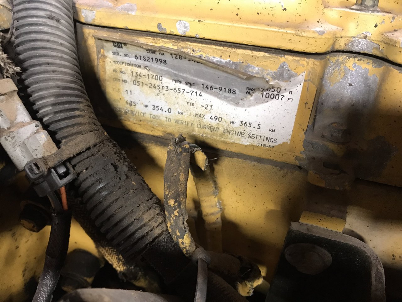

  10. ShooterK2
    ShooterK2 Road Train Member
    5,533
    89,470
    Dec 14, 2012
    Oklahoma
    @pushbroom I’m looking for any info you can give me on 6TS21998.
    Odometer is showing 2.1 million miles. Wondering if it shows when the last rebuild was.
    Thanks in advance sir.
    Oxbow and SAR Thank this.
  11. Oxbow
    Oxbow Road Train Member
    13,732
    142,484
    Nov 24, 2015
    This is all I come up with Shooter, Pushbroom will have more info:
    3406E TRUCK ENGINE
    Engine Serial Number - 6TS21998 (Build Date - 10/10/1997, Test Date - 10/10/1997, Ship Date - 14/10/1997)
    134-1700 - ENGINE AR-COMPLETE (6TS21998) (As Shipped)
    134-1700 ENGINE AR-COMPLETE
    S/N 5EK72728-99999; 6TS1-27811
    354 BRAKE KW (475 BHP) AT 2100 RPM. PETERBILT, JAKE BRAKE 01/11/2018
    pushbroom, ShooterK2 and SAR Thank this.
