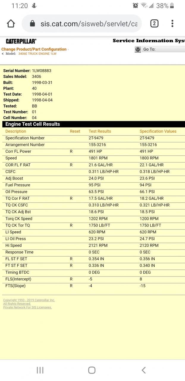

    Hi ! What is 1LW08883 ???

  5. Oxbow
    Oxbow Road Train Member
    13,686
    141,969
    Nov 24, 2015
    Pushbroom, do you know what adjusted boost means? Do they take into account intake air temp and adjust the boost downward to mitigate the higher intake temp under boost?
    Just curious, thanks.
    SAR, Wheeljack and pushbroom Thank this.
  6. pushbroom
    pushbroom Road Train Member
    1,791
    7,403
    Sep 1, 2012
    Honestly not sure. Possibly boost at sea level vs wherever the test was done?
    @spsauerland might know more

  8. spsauerland
    spsauerland Road Train Member
    4,296
    10,891
    May 31, 2010
    West Harrison, In
    Yep, numbers are corrected to barometric pressure of 29.31 and 77 degree F intake air temp. Also, corrections for fuel temperature and fuel API gravity. Here is the performance spec for that serial number.
