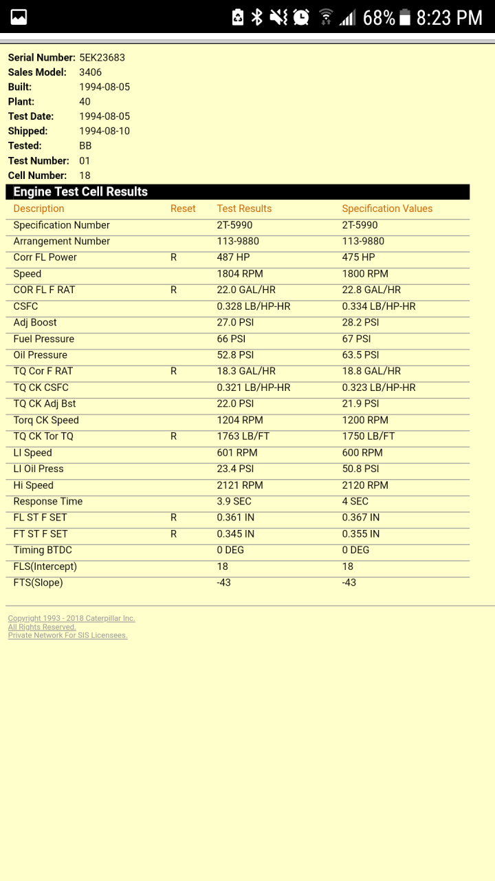

    Ok I have another 5ek number if someone would look up the info. Supposed to be a 475 hp. Just wanting to make sure that’s correct. SN is 5ek23683.
  4. pushbroom
    pushbroom Road Train Member
    1,790
    7,400
    Sep 1, 2012

    Thanks. I’ve got a 2011 Pete with an isx. Been trying to find a yellow motor to go in it. I’d prefer a 2ws or 5ek.
