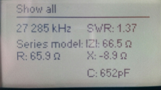

    X=8.9 is a bad thing.. that's partially responsible for your extra impedance

    That 66.5 ohm reading..WTF is it..Is that supposed to be impedence? Oh and ifs a tad high and resistence as well and resonce is a lil off,you can squeeze some better #'s from your set up

    Rabbi..thats a negitive 8.9 not a positive 8.9

    Not good either way actually

    X doesn't cross the 0 line and go positive until 36.985 mhz.

    But then SWR is through the roof at 36.985... 11.8

    Well depending on the freq you wanna tune for resonce you need to adjust your whip to make messary change

    Impedence should be as close to 50 ohms as possible..The resistance should also be 50ohms and the x should be 0 at choosen freq..

    Wrong ... sort of.
    You won't see 50 ohms resistance or should see it.
    The x is not really accurate measurement, because to complete the antenna thing, you have to take in account three components of the system, Xr Xc and X L.
    I know I'm not explaining it well, stupid cold, but if your X<0 then you have inductive reactance, X>0 you have capacitive reactance and if X=0 you have then the impeadence is resistive.

    Z is impedance, which, as I understand it, is the sum of all resistance to current flow... reactance, resistance, etc.
