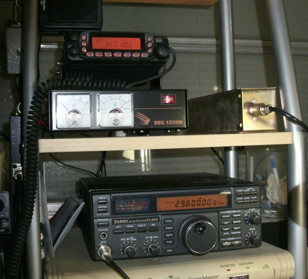

    Yep the A-99 works fine ....
    I'm also on 10 meters Lissing on 29.600 FM.....
