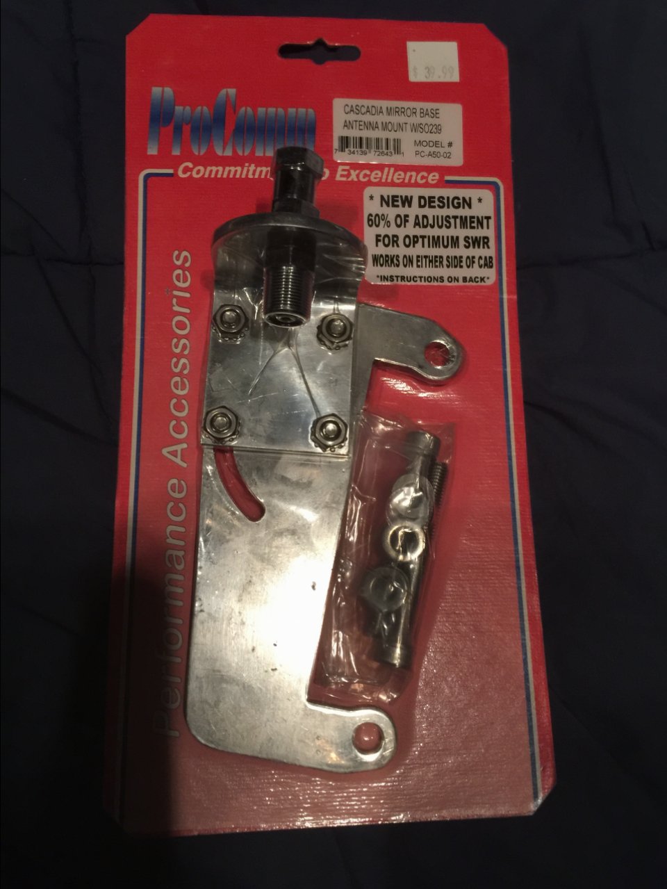

    Btw, I did buy a 5ft Firestick II and a mirror mount bracket. The bracket is kind of neat. It's not a Wilson bird perch type mount. I've been kind of worried about using a Wilson mount. I know a lot of people use them, but I've also heard they aren't very sturdy. This mount that I got looks like it would hold up any type of antenna you wanted to throw on it. I will try to post a picture of it if I can figure that out.

    Nice bracket. That should work. Make sure your 5ft antenna is top loaded. Most fiberglass whips are. You can tell if you see the winding closer together (tighter) at the top of the antenna. The only problem with that mount that I can see is with the bird perch type you can slide the antenna further away from the cab. The mirror won't change the SWR reading, but the closer the antenna is to the cab, the higher it will be.

    I'm pretty sure the antenna is top loaded. I know it has the adjustable tip on it. I had the same thought as you about being close to the cab. I had seen your comments about that before, but I decided to give this a try anyway. I will let you know how it turns out once it is all set up. I still need to get a cable and then get everything all set up. I'm guessing I could just get the cable at any truck stop? That would help as I could use my points to get that. From what I've read, I need an RG58 cable. Is that right? Is the Wilson cable RG58 and is it any good? I've seen "mini 8's" and "super mini 8's". I just want to make sure I get the right stuff. And you still didn't answer the question about just how bad of an idea is it to run it thru the door jam. I know it's not ideal, but I need easy removal in case of a truck swap.
