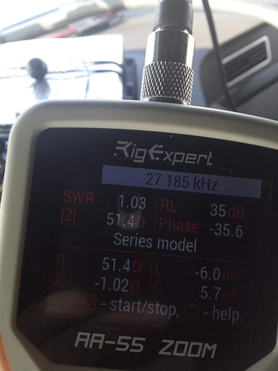

    Dont know why mine is off but last time i checked a few weeks ago it was almost perfect on 19..Hopefully i just gotta clean some connections cause the steel lock screws in my 10" alumium shaft have siezed,so must be crap in there somewhere..Clean my braided strap connect points to..
    Anyways just to show resonance changes with freq..

    This was my last test ages ago..

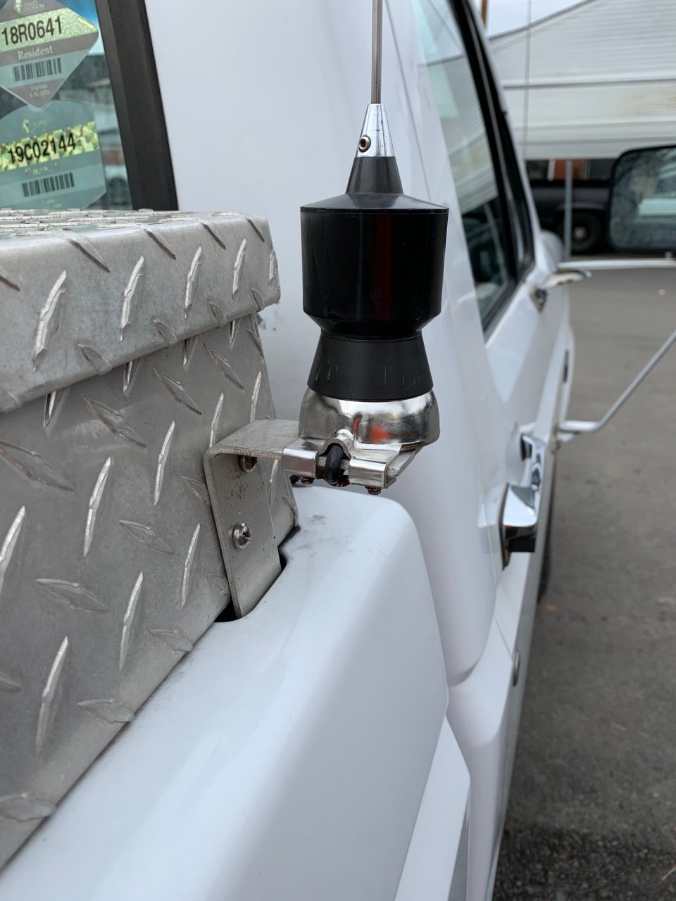

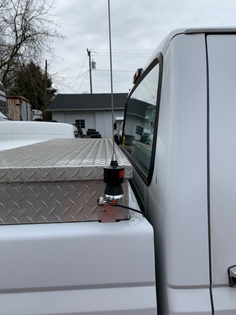

    The antenna part that sticks up into the air is only half of the "system". A good "ground" is also important. You can think of it like AC electrical current in a way.
    What the antenna is mounted to is also part of it it. Especially any flat/horizontal metal areas adjacent to the antenna. Like the flat lid of your toolbox, the lid conducting to the tool box, the toolbox connecting to the bed of the truck, and the bed connecting to the cab of the truck.
    Some people go the the extreem and ground the frame and exhaust as well. I'm sure it helps to some extent, but it's akin to running down a rabbit hole.
    I would initially think it would be a coax issue. You antenna looks new and the coax, while not the best, shouldn't be an issue just yet. You have to rely pinch it a couple of times to break it.
    If you have some junk wire laying around I would try to make sure you hav somewhat of a reliable connection from your tool box lid and between the tool box to the bed, and from the bed to the cab. That should be a cheap and easy test.
    Radio frequency prefers more surface area so flat braded wire or flat ground straps are better
    But at this point I dont think you need to there. Just any wire you have laying around to connect the top of your tool box to the frame of the tool box, and then the box to the bed, and the bed to the cab, should be enough to see if that is the issue. Just the lid to the box and the box to the bed should be enough to tell.

    So.....Did some clean up on ant mount,changed braided straps on my door hinges and tadddaaaaaa
    So folks,your not always gonna know just by swr if your system is outta wack for any reason....
    I knew cause it seemed like i wasnt rec as well as normal..Sometimes its conditions to but i grabbed my analyzer and saw my system was off..
    Between my analyzer and multimeter if found out i had a crap build up as you see in my pics....So every so often guys,giver a clean..
