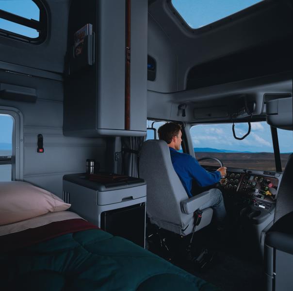

    Like brsims.........said. Look in the square cubby hole above center of the windshield. The wires should be there unless someone hacked them.
