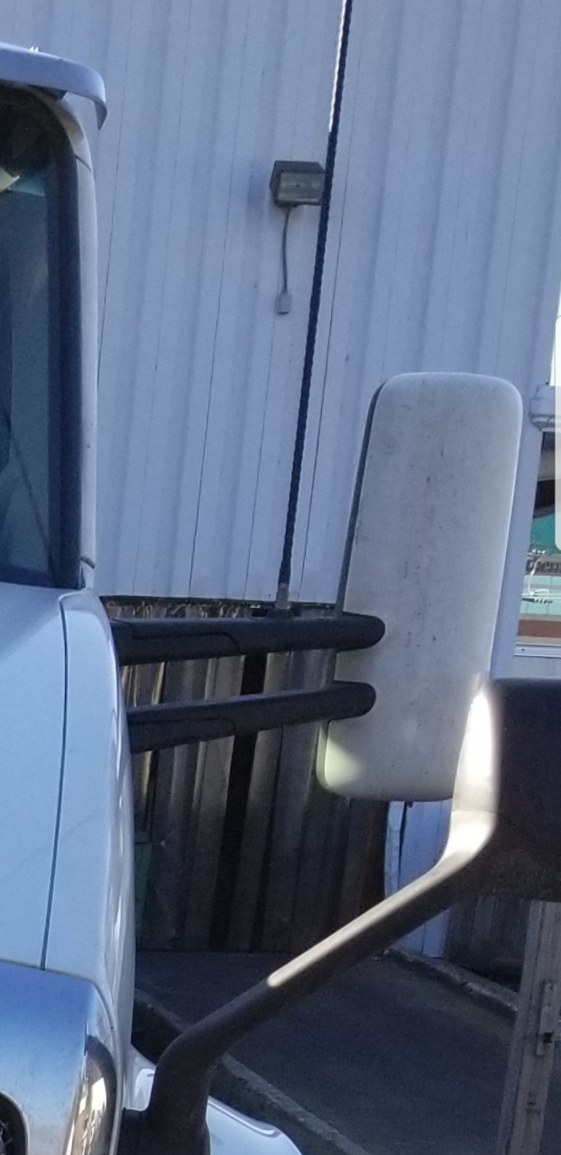

    It was something I designed for my personal use and was made in small quantities. The guy that made them passed away last year. You can make something similar for less than 50 bucks.

    Do you have a thread on how you built that Antenna? Or where and what you used for the bottom part? Looking for a 24 or 27" Extension for the Antenna's I have now. that would get them above the cab on my T600.
    Bottom section is 7" now. Need to get it about 2ft or more higher. Going to try to find some SS Rod and make my own bottom section.

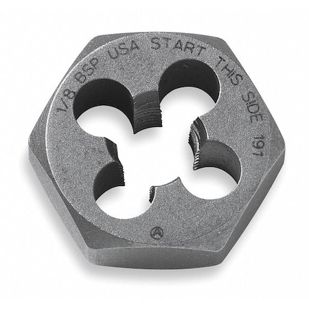

    $2.42 for the die to cut the threads.
    Irwin Hanson Hex Die, High Carbon Steel, RH, 3/8-24 6536 | Zoro.com
    Total cost $34.50 .

    What does the mount look like up close on the back side?

    Unfortunately same as it does in the front, screwed into a plastic extension for a mirror

    That mount comes stock on the tractor I have... threaded female into a piece of plastic. That's really all I have to work with...screw something new into it
