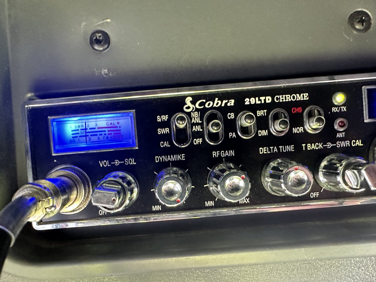

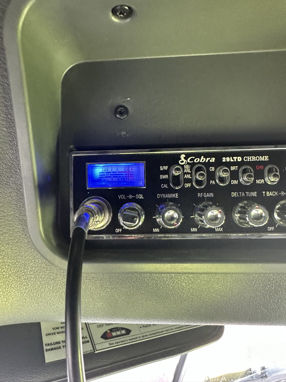

This is what my radio looks like in keyed in normal mode, and then the second one is when I am keying in normal mode

Thanks for the pictures, that helps a lot. I'm not sure why the first picture shows the meters needle about an s3 while the other picture shows the needle around an s30.

And yeah, like I said, the first picture is when it’s just normal operation I’m not using it and then the second one is when I key the mic. Are those not normal readings or something?
Oh okay, no that's fine, for some reason I thought both pictures were showing it in transmit mode. My mistake.Brianjr323 Thanks this.
