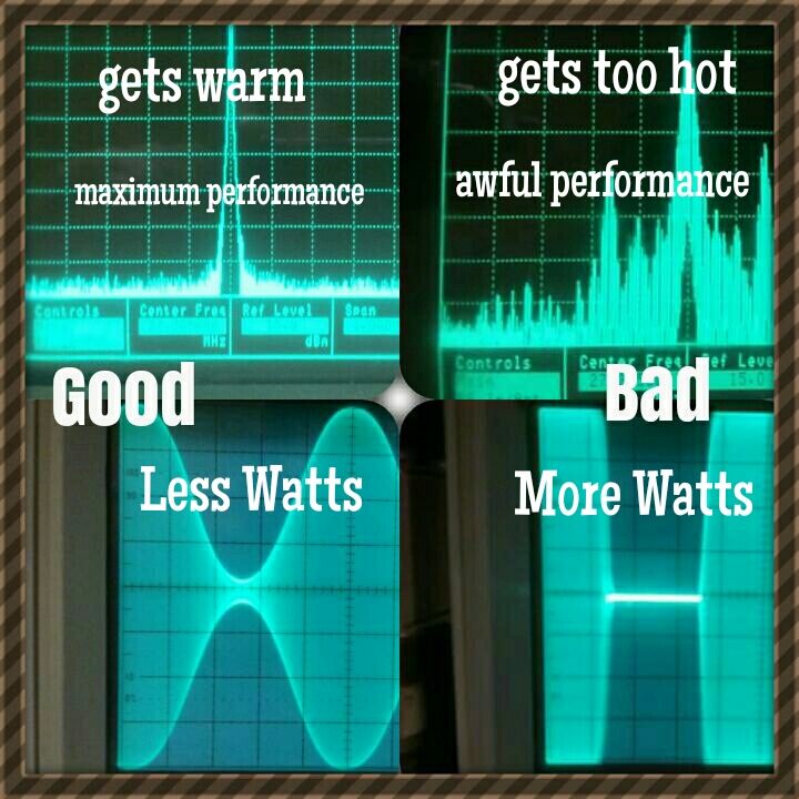

    to i believe a good radio shop are the ones who are honest.... there are alot of people out there who says and believes they can make the radio tune up and perform better than others now just because they tuned doesn't mean they did well. Any one who charges more than 45 dollars to do a peak and tune means they dont even complete the job or the complete it and took out something they dont need to take out especially.
    Now the clipping of the D9 isnt an issue at all that is an actual professional way of doing a peak and tune, you need think of the modulation circuit as like a govnor that is set in a vehicle if the govnor is set up for you to only go 65 mph than you cant really get the use of all the HP that your vehicle has. so the d9 was just acts govnor when its snipped you can use 100% of your power in the radio if you dont then what you get if you dont do so is that your radio will lose modulation during the duration of you time talking but after a while it rebuild its self back up.
    trust me or not i grew up in this stuff i have done business face to face with galaxy and connex, as well with General and know this very well and they say to in order to peform best im not no trucker but i am a radio technician.

    So I can clip d9 in all my radios to get big bird watts? Awesome!!!
    Id really like to have big bird watts and low swrss so I can get max range

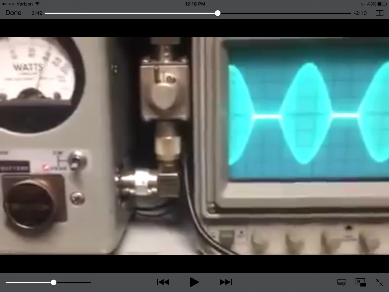

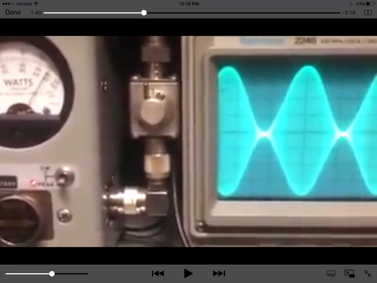

    So based on your comment here its ok that a well known shop can take a 400ish watts radio,do his tricks and get another 200 plus watts,post the vid of the bird watts and your not to question his work???
    I dont know alot but i know a lil and when said video was posted i asked to see that vid with a scope,signal generator and such and the reply was no cause he was to busy to include that in his vid.....
    So now the owner of said 600+ watt radio is gonna go out thinkin he got some stank on his hang low and walks n talks the dog all over,in reality all he is doin is fryin an egg with splatter power and channels 5-10-20 up and down the band from the one he is on...Not to mention the sound quality is all but gone..
