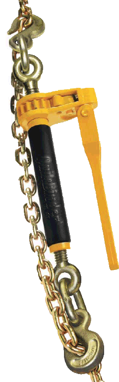

    Has anyone used this style of fold over ratchet binders? They are only about $10 more than the regular style and seem like they would take up a lot less space in storage.

    Those are pretty slick. If I were still doing flatbed, I'd get one or two to try out. If they work out and worth the extra $10, I'd get more. If you get some, let us know how they work out for you.

    I used them a couple times when I ran someone else's trailer. I found they were annoying to flip them into position and didn't like that they could flip possibly when ratcheting.
    Space was never a concern for me though. The ones I used were old and rusty tbf. I'm also fussy on my binders.

    I use those kind. 3/8-1/2 binders with a 13kWLL. I have those kinds and snap binders. I put machine hooks on one side of 4 of them. First thing I reach for when I'm pulling machinery.
