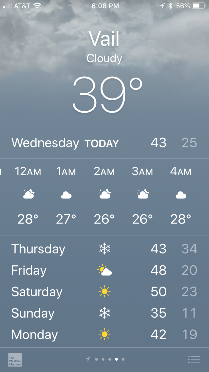

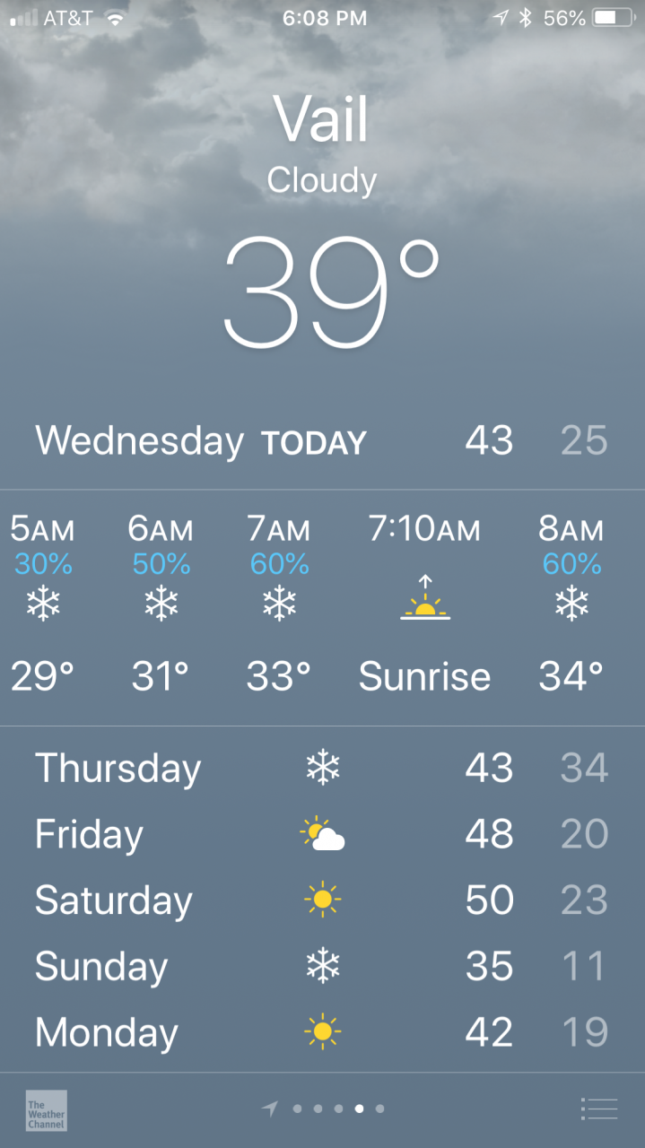

My normal leave time is 1am or so. I’m thinking I should wait till 6am. I can deliver anytime tomorrow in Cheyenne and then have a preloaded trailer in Aurora to pick up and haul back to LA. Would love to be home by Saturday night.
Then I see this... thoughts?

Personally I am a big fan of the wee hour start. One thing to consider, if you aren't familiar with the hidey hole places to park, from Denver to Grand Junction can be a nightmare looking for safe, legal places to park for a 10 or a 30. I try to have as full a clock as possible before tackling that passage. Do NOT plan on spending a 10 at the rest area near Vail. The altitude is nothing to mess with, altitude sickness can quickly progress to a medical emergency or death. In winter getting in or out of there can be dicey.
Bring a bag of sand or kitty litter. Often you can get enough traction getting started from a slick parking spot without having to chain up to reach bare and dry road. -

Time your arrival times to that pass,if you hit it right you can sail, Just watch out for the traffic from them cities down below, they all go and leave at the same time.Lepton1 Thanks this.

If you chain up and are going in the right direction you will be out of the storm sometimes in a few hours and be ahead of the pack that will flow when the restrictions lift.
