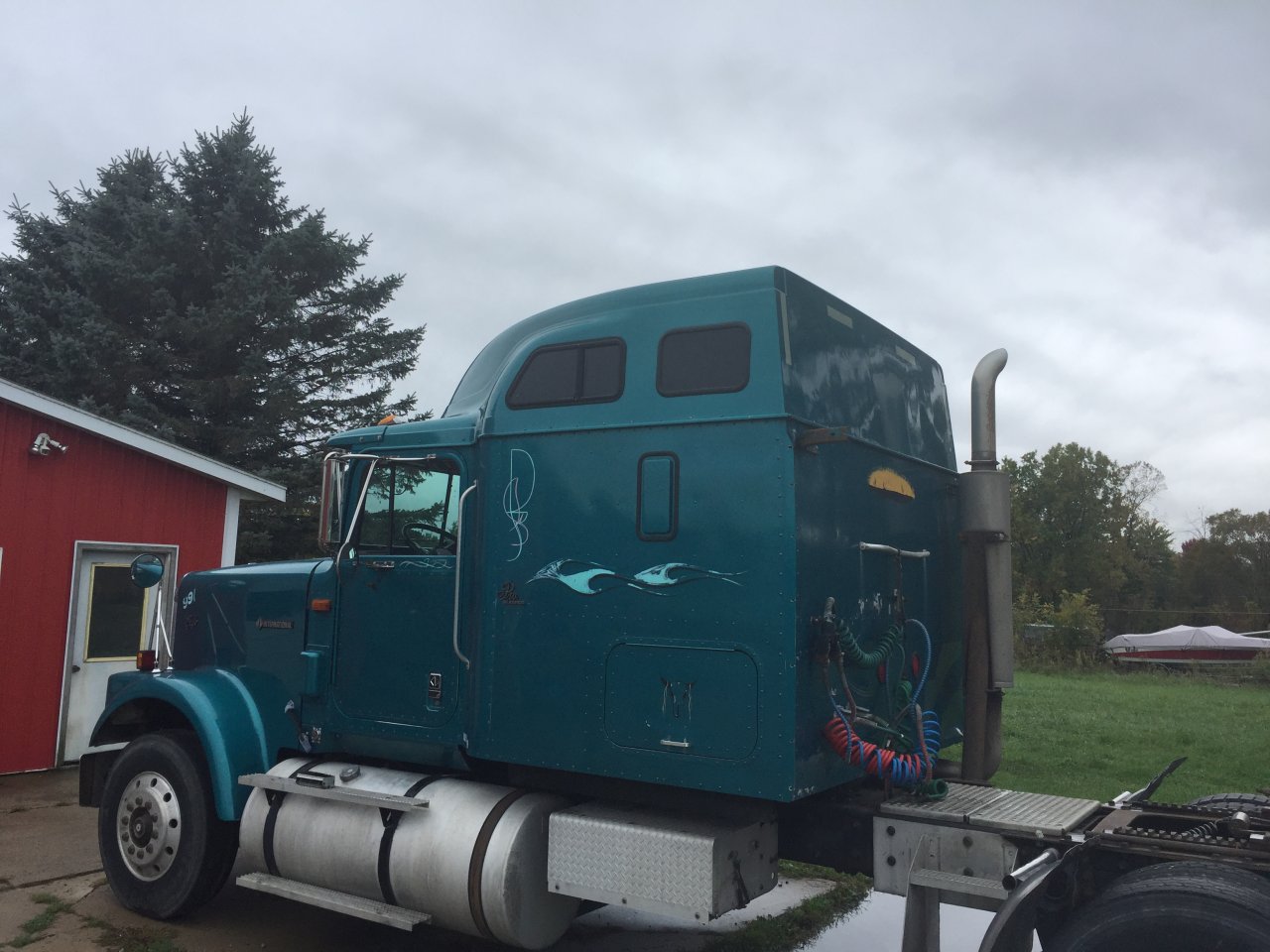

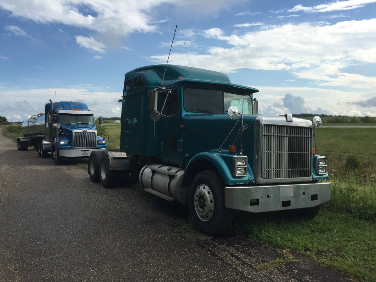

    If i put my old wreck on the road this is my mechanical plan .
    Pull my fifth wheel and thoroughly inspect and rebuild if rebuildable. If not a new or used takeoff if i can find one.
    Priority one.
    Than pull the axles and inspect everything and replace axle seals and fluids and pinion seals
    Brakes,drums,cams,cans Rubber lines and plastic lines. Airbags , new led taillights .
    Inspect drive shafts and replace universals and carrier bearing .Verify my set ride height is correct
    Clutch only has 300 thousand on it but will visually inspect it and the throwout bearing and clutch brake
    My 13 speeds shifts well but needs the tower rebuilt , new tailstock bushing and seal and mount plus fluid.
    Pull the front hubs and inspect and reseal as well as thoroughly inspect the steering and suspension parts along with front shock replacement. Inspect steering box and pump. Replace hoses.
    Inspect the condition of the radiator and have recored if less than top notch condition.Newradiator hoses and inspect metal tubes in cooling system loop for corrosion .
    New heater hoses and clamps for heater cores .Inspect and Rebundle frame and cab wiring.
    Replace starter with new high torque unit along with new starter positive cable. Throw old starter in sidebox of spares.
    Inspect all battery cables and replace batteries if more than 2 years old.
    New water pump on my n-14 and accessory drive. Might do the oil pump also since their known to free spin.
    New alternator and belts. Throw alternator in spare box.
    N-14s Cummins are known for bad injector harness so long as I have the rocker covers off to Run an Overhead install a new one.
    All new Rubber fuel lines as well as solenoids and check valve.
    Service air compressor and drier and valves. Flush out air tanks and inspect for internal corrosion .
    Possible turbo replacement after inspection for wear and oil leakage new turbo hoses and clamps if needed.
    Inspect and recharge A\C system
    Replace air clutch on fan.
    Replace piston cooling nozzles .
    So not much more small stuff left to replace other than kingpins, springs ,hangers,bolts, torque arm , leveling valve.
    And this is all on a well cared for one owner truck with a million175 and a perfect oil analysis report that with new brake shoes and tires would pass a DOT inspection
    The interior pics are my old company western star and how i had it set up for livability

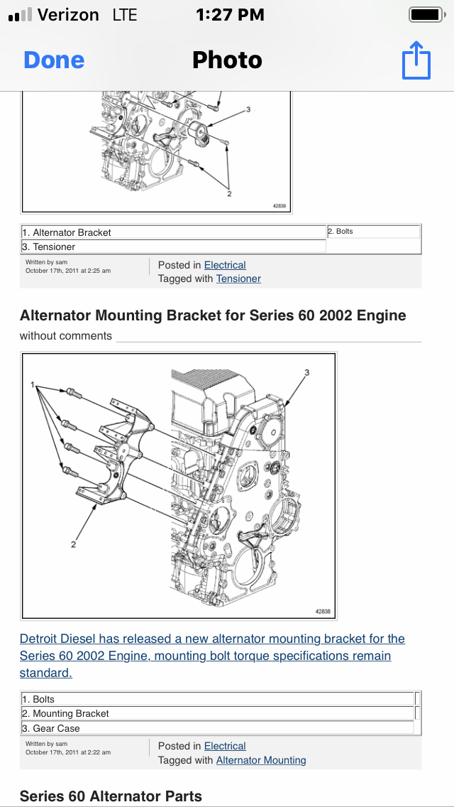

    You’re way ahead of the curve. You could overhaul a 12.7 yourself. I just had mine done in in January. The cost for parts isn’t bad at all. Bull gear added almost $3000 to the cost. They’re good engines, Bull Gear, and alternator mounting brackets can be a problem. The Holes in the front covers get wallowed out, from bracket bolts. The bolts tend to break. Something to check, when buying one. There’s been a couple upgrades, the best one is 2002, and up. Different bracket and front cover.
  10. Rideandrepair
    17,583
    56,952
    Aug 8, 2015
    5A41BC88-52E2-4F90-89F5-2486A3913AE0.png Here’s a pic. I replaced mine with original covers and bracket. Had I known about the newer design, I would have gotten the new style ( inner) front cover, and bracket instead. Note the 4 bolts in the top of bracket. That’s the upgrade.
