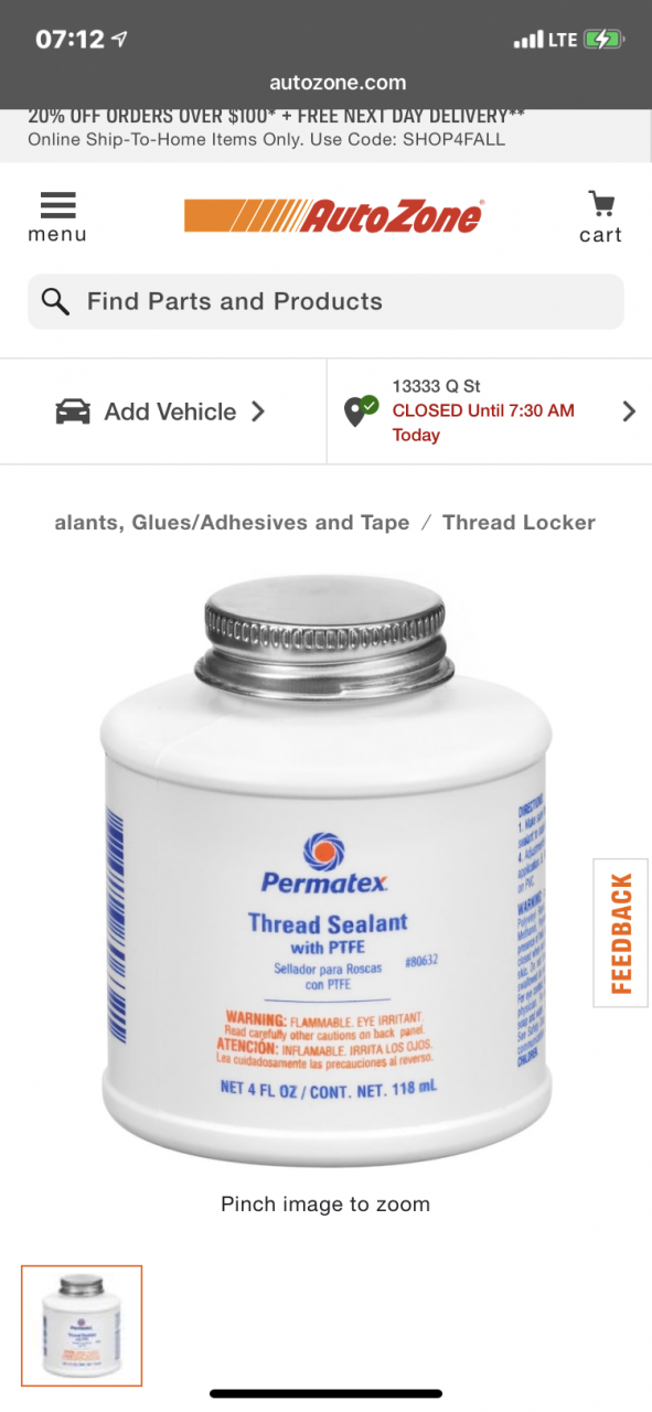

    Just a FYI: the liquid thread sealer is easier to work with in tight places.
    little white bottle
  4. feldsforever
    feldsforever Road Train Member
    1,453
    1,440
    Nov 22, 2019
    Thank you ill look for it.
