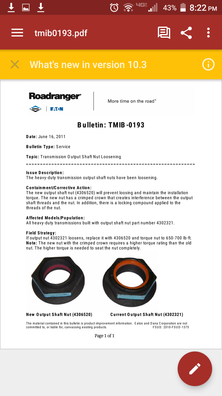

    I think Eaton increased torque spec to 650-700 ft/lb awhile ago.
    Rideandrepair, Oxbow and BoxCarKidd Thank this.

    Ok I’ll look. The directions I saw from Eaton were 450-500 on oiled threads.
    Rideandrepair and Oxbow Thank this.

  9. spsauerland
    spsauerland Road Train Member
    4,296
    10,891
    May 31, 2010
    West Harrison, In
    I think the nut has changed again since the one in the picture I posted, but newer manuals call for 650-700 ft/lb.
