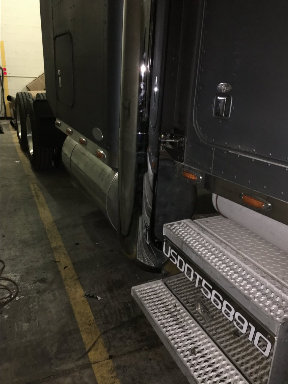

    I just got this kit from 32 chrome. Its there peterbilt economy kit came with everything needed minus the T pipe for under the truck I bought that else where. Its the 8" kit with pickett elbows that reduce to from 8"to5" under the cab. I ran the truck for a week straight piped but the jakes were crazy loud, so i went to my local muffler shop and got a magnaflow 5" in/out high flow truck diesel muffler thats around 24" long and mounted it under the truck to help quiet things down a touch. Its still loud but now its not obnoxious when the detroit hits the jakes.
