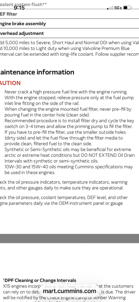

    So it appears that I’ve been doing it wrong for years.. always prefilled before screwing it on. Same with my oil filter..
    Cummins recommends installing it dry..any thoughts on doing it this way? Sure would make my life easier since these filters on my 2023 is about four inches taller and heavier than my 2021. Full of fuel and the fine threads can be a beach sometime.
    Just stumbled across it while doing a little research on changing my first power steering fluid filter..guess I should have been doing this one every PM..instead of after 400k.
    Still living and learning..
    Started doing everything myself after the third oil filter coming loose and leaking oil. Techs were only putting them on hand tight my guess.

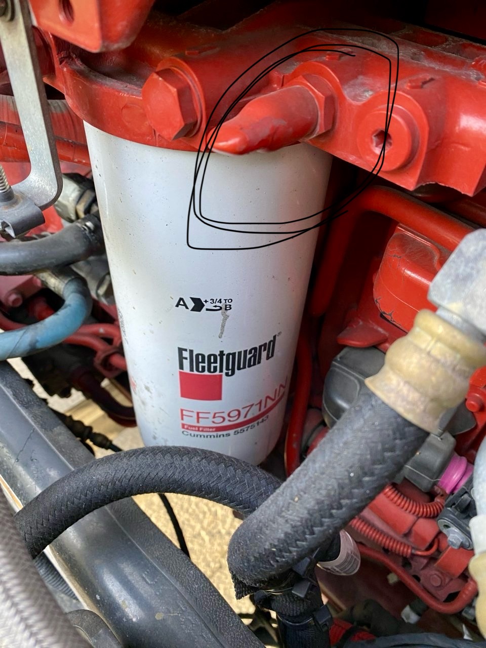

    I’ll tell you how I do it not saying I do it right. I pull that cover off the compucheck fitting I circled in above photo. I have a fitting a 3ft hose and ball valve put together. Hook your hose up and turn key on so electric pump runs. Open your ball valve pointed into catch container of your choice. When the air is out of your hose the filter is bled and she’s ready to run. Remove your bleed hose and reinstall dust cover, with the longer filter I also remove the 8mm bolt and move oil dipstick to make install easier.
