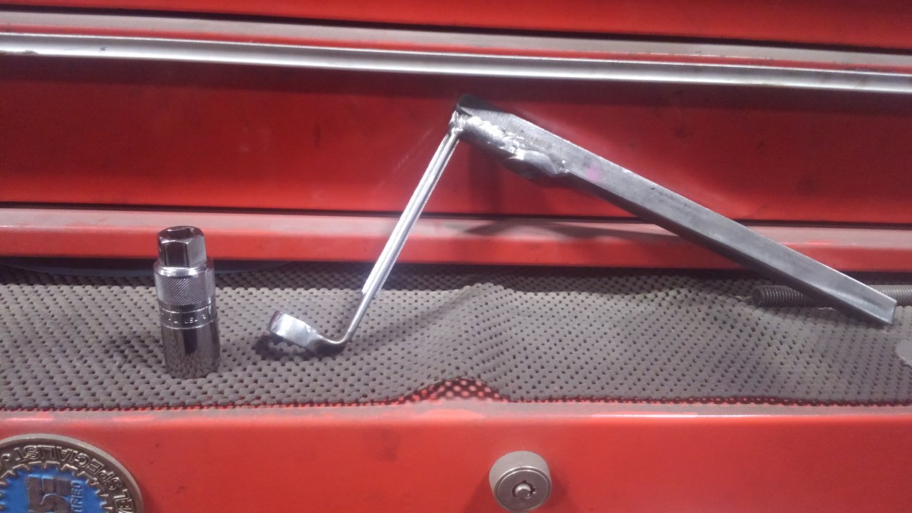

    Not sure on dyno in Texas, up here in Hoosierland. Did live in Killeen for a bit while in Army. I second making overhead set priority. Besides the barring tool, I have found that a Tee handle Allen wrench and 18MM spark plugs socket with hexhead on socket makes tightening jam nuts easier. Made a special wrench, but spark plugs sockets are much nicer. Trick I learned from Isuzu service manual. With yours seeping water so fast after HG install the first time, hopefully maybe gasket was damaged on install. I wouldn't even think of putting head back on without checking protrusion and having head pressure/cracked check @ machine shop.

    A picture off said tool might be usefull?

    Snap-on Store
    I use this pass through socket set for doing valve sets on paccars. Center is open to run a t style allen wrench.
    Paccar rockers sit low in the head so a wrench doesnt fit good.

    hmm saw the pics pretty kool ill try that,
