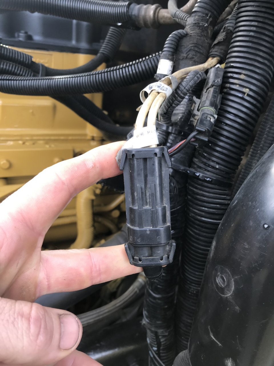

  5. Cam Roberts
    Cam Roberts Road Train Member
    1,621
    1,938
    May 13, 2018
    This plug is for the starter relay on my pete. I need new plug and the pins inside. Do you know the name or part number on this plug and the pins. Having hard time searching for it. Peterbilt didn’t have any and forget the name of it that they told me

  7. spsauerland
    spsauerland Road Train Member
    4,296
    10,892
    May 31, 2010
    West Harrison, In
    Looks like a standard weather pack 2 pin connector with 12 gauge wire.

  8. Cam Roberts
    1,621
    1,938
    May 13, 2018
    Ok thanks. No big deal if I just cut it off and bypass it for now with connectors right?
