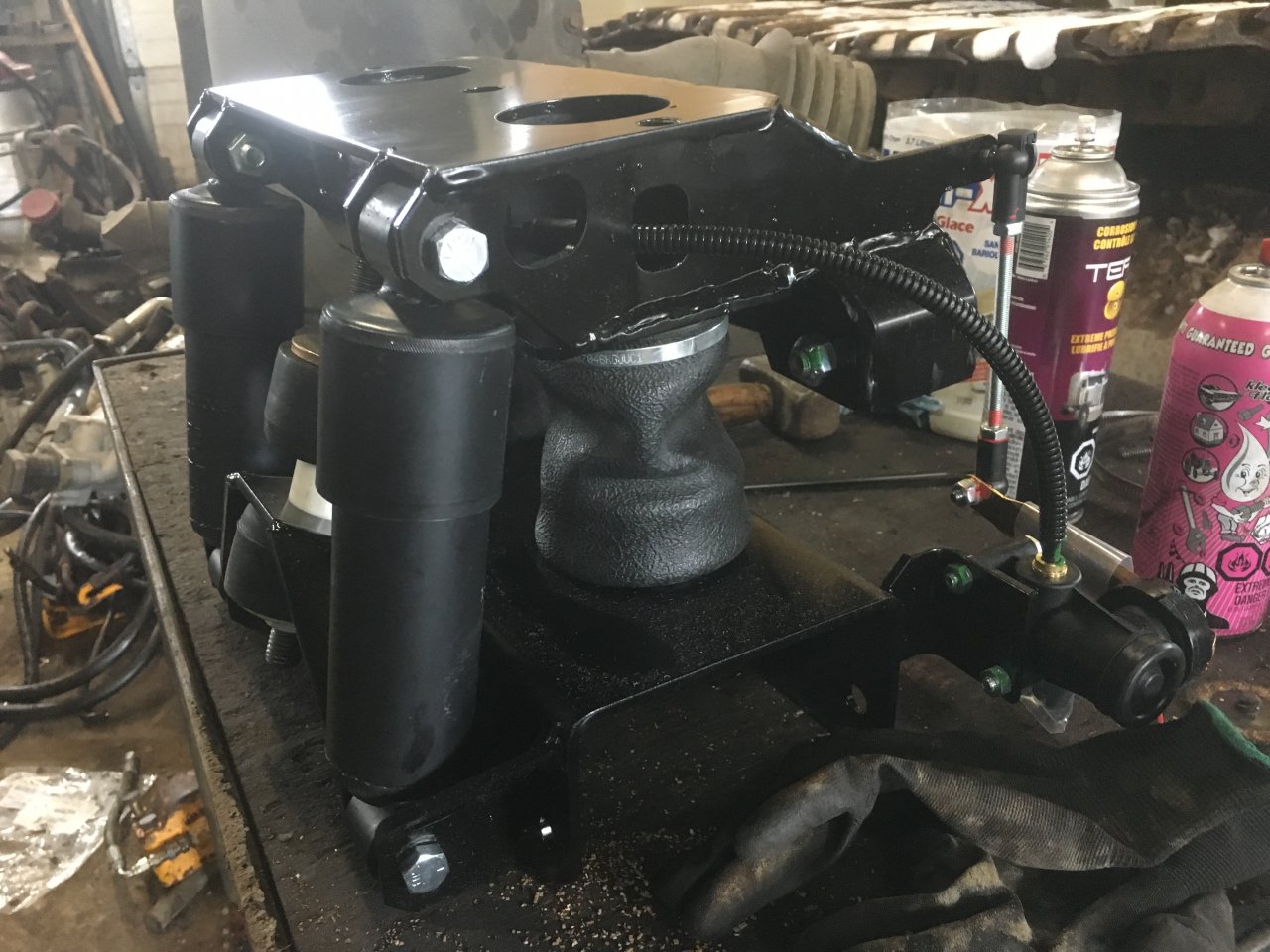

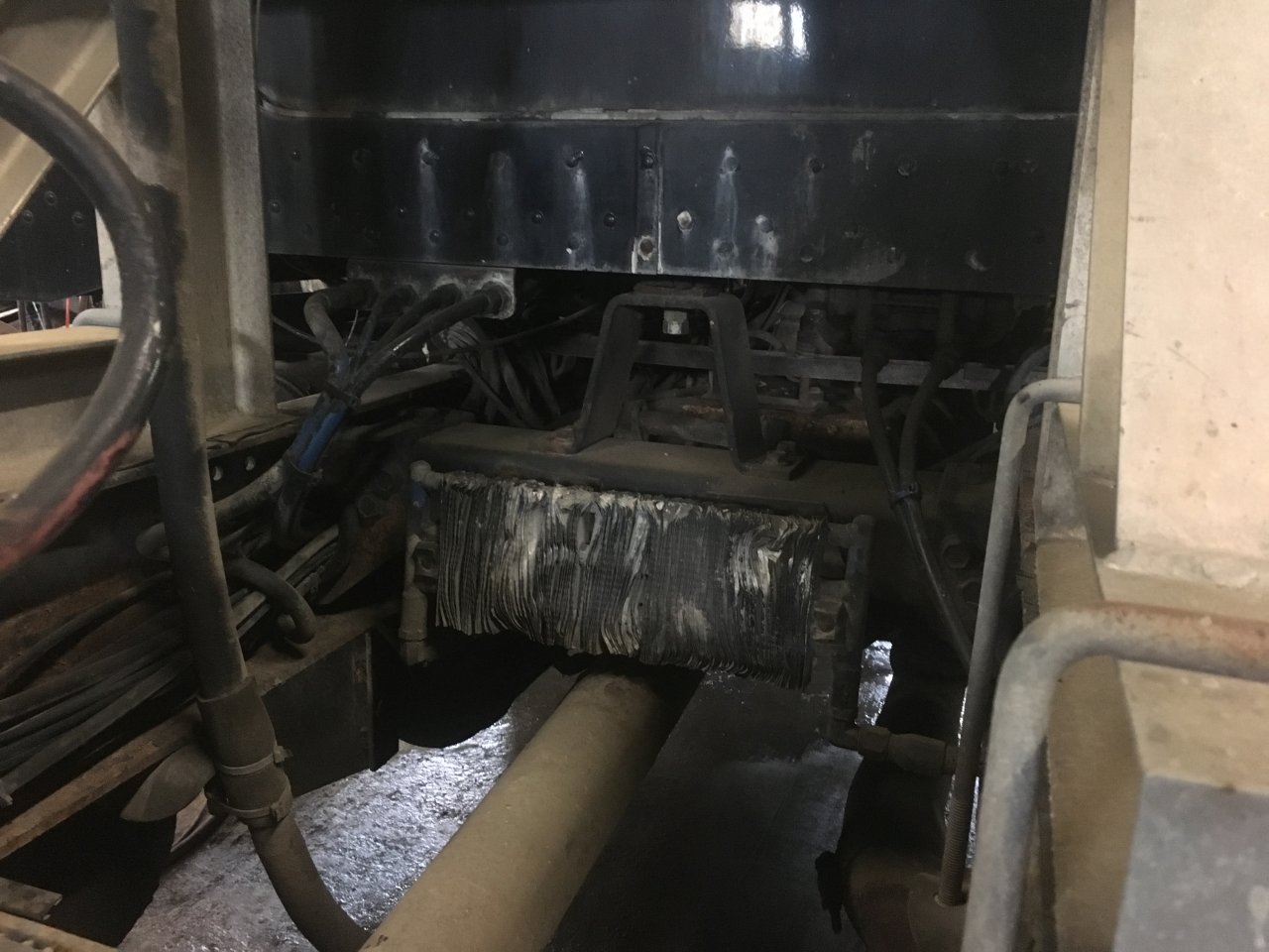

    We just did a cabmate linksys air ride install on a 1987 Pete 377 a month ago.
    4DA7672D-3D92-4914-8439-A3CE814DD792.jpeg 24A4B614-894B-4BA5-8F7F-AC4A00338A5A.jpeg
    Works good.
    I don’t have the finished photo. I thought I did....

  10. Shawn2130
    Shawn2130 Heavy Load Member
    896
    1,900
    Sep 20, 2015
    Southern Ontario
    Mr79w900: sorry for the late reply, the cab mate is a pretty straight forward install.
    No modifications to the air lines or tranny cooler.
    The holes for the cab mate were already in the crossmember from factory.
    Just had to unbolt the rubber cab mount, remove that, unbolt tranny cooler, air lines harness, drop the air ride bracket in and re install.
    It was my first time and took most of the day as it was tight to work in that area.
    Radiator mounts are still original. Nothing else changed.
    We have 2 Peterbilts, one has air ride cab and the one I did didn’t.
    So I used that truck to see what should be changed but really don’t see anything.
