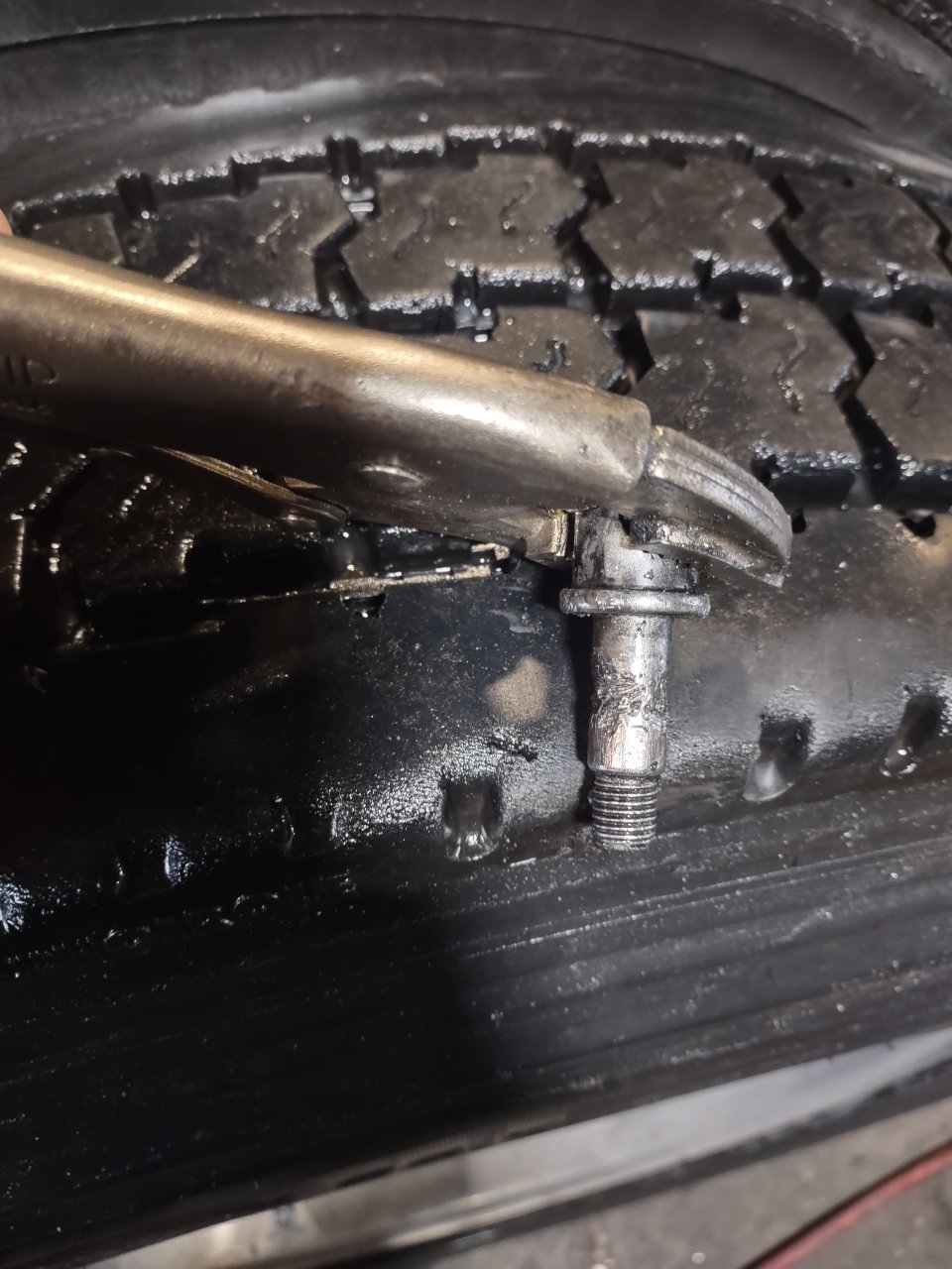

    Almost lost a dual tire the other day. Somehow the inside tire stem came loose and lowered the PSI and about ruined my tire. Luckily I caught it in time and do not have to replace it. I have TPS on the tires but the inside tires are ruining the sensors and making it harder to keep an eye on them. This is one of the reasons I am considering changing.
    The tires will last for this summer and maybe into next year. So making some plans if gonna change them. I am not ruling out keeping the same set up either and have looked into changing TPS system as well.
