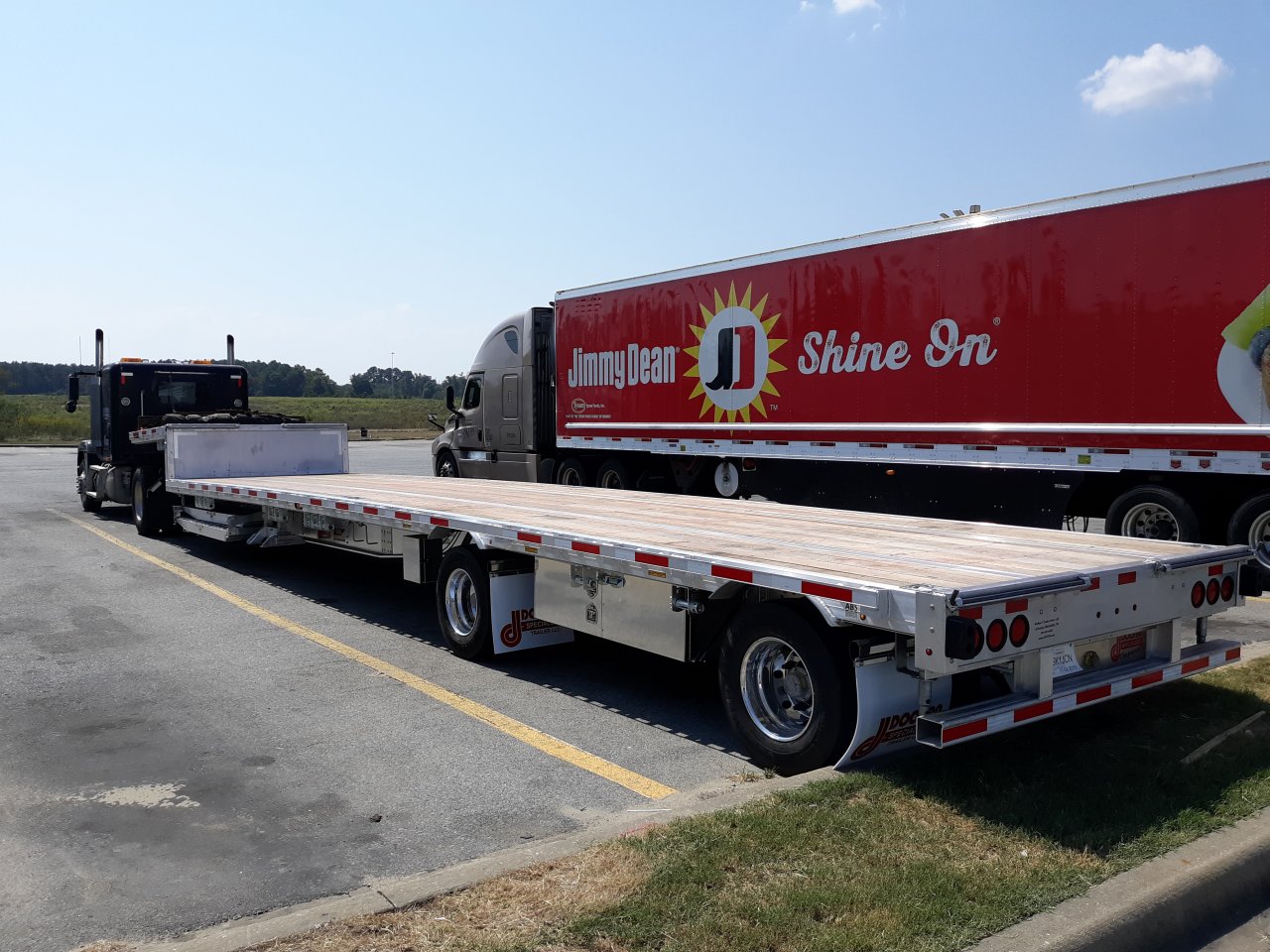

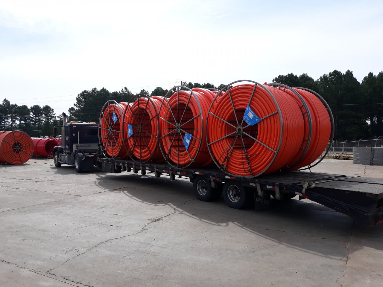

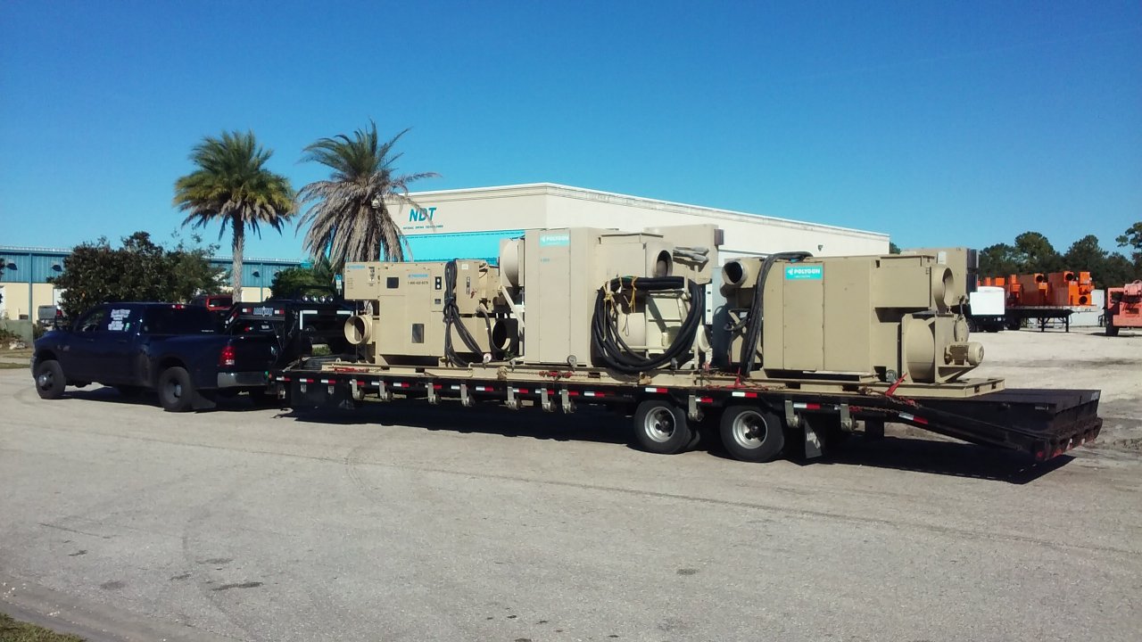

    Went from this
    To this
    To this
