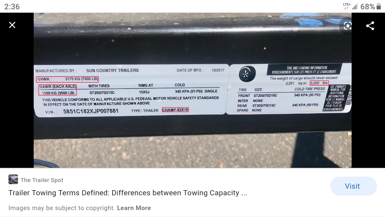

    You see where that sticker says "the weight of cargo shall never exceed". Over there on the right side..?
    That is where you can get into trouble with de-rating. The sticker will be below what the trailer can handle axle, let alone any weight transferred to the truck/tractor. I had a "smarter" state trooper in NY compare the weights listed on the BOL's of a couple of partials I had on deck to my sticker like that. I was under, but he said I'd have been shut down for having overloaded equipment..
    I follow what your saying. My gooseneck "could" have been rated up to 30k lbs the way it was spec'd. It was rated at 25900lb to avoid the 12% fet tax. It could carry 19,740lb - the tare of 10,260 for 30,000lb. But the decal said not to exceed 15,640lb, because it was de-rated to 25,900lb..
    I promptly tore off the sticker that evening, & continued loading it up to about 17k lb with that dodge.. LoL
    Maybe the sticker falls off.? Should be fine though..
    Now you have, LoL.! Just got to run into the right one.. ;)
    Also the 65' rule has no bearing on having a CDL A, or not.
    Some states allow over 65' with a pickup/flatbed. Best to just remove box/bed if over 65' so legal in all 48 states. Unless running just the few that allow those lenghts..
