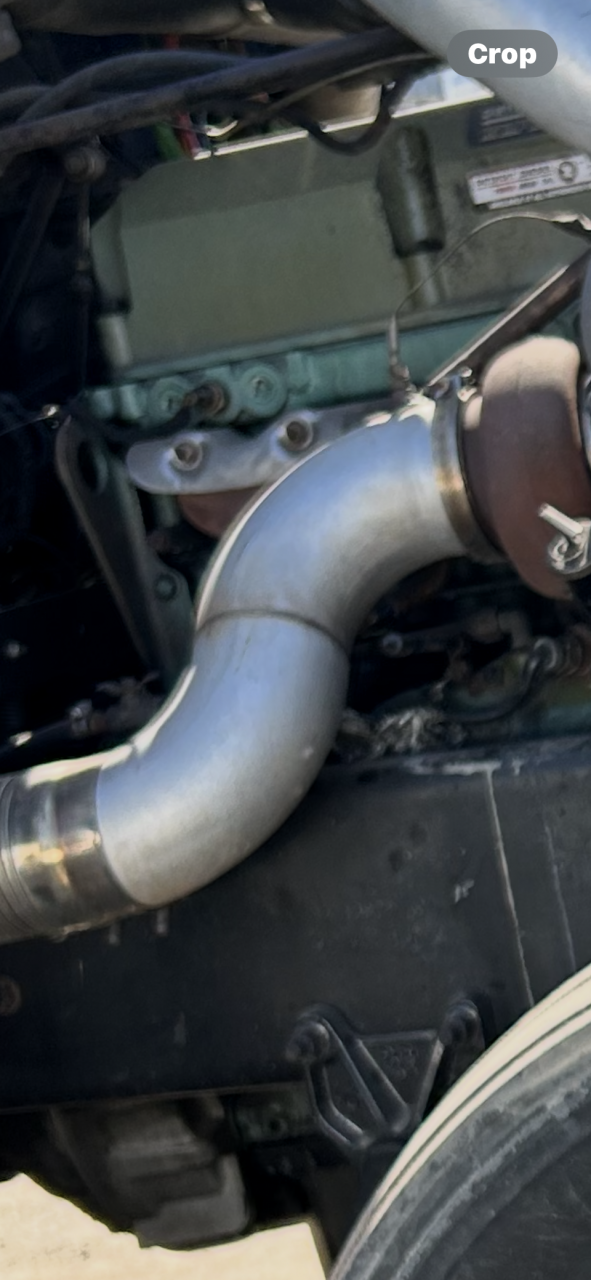

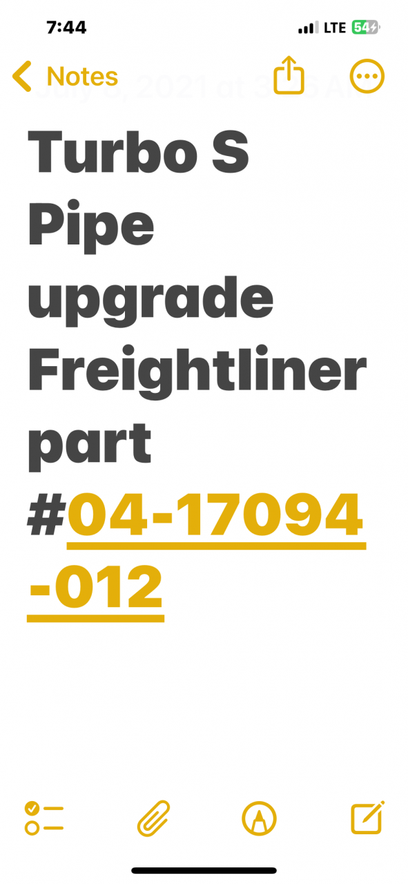

    IMG_6366.png You did good. Same Truck I have. I’ve been able to piece together things a bit over the years. 6” straight coupler at end of Y pipe, Add a cheap type flat clamp over a hole. Cur the rusty end off of base of the stacks. The Y pipes rust at the Y weld. I thought about re enforcing a new one before installing it. Never did. Considered singling the drivers out as a dummy pipe. Best upgrade was the S pipe at turbo. 2002 and newer uses a longer pipe. Flex lines up better, lasts much longer. In case you have the old style. IMG_6365.png

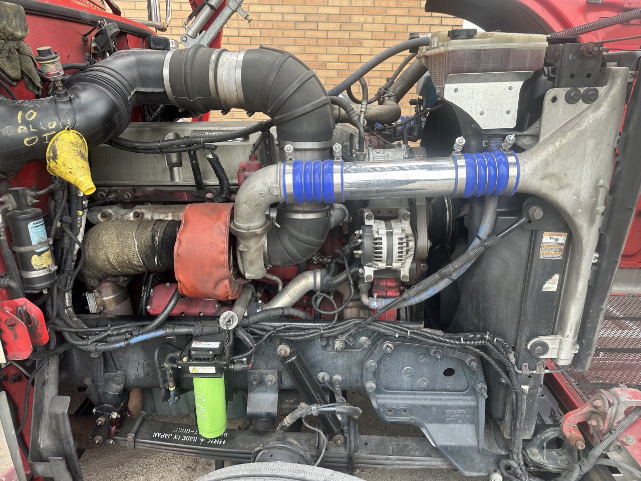

    Have you thought about wrapping the pipe and a turbo blanket? When my rig was new I noticed my wire loom was prematurely aging due to heat under the hood. I was surprised how much heat was kept out of the engine compartment and away from my wiring after I did both. IMG_5632.jpeg
