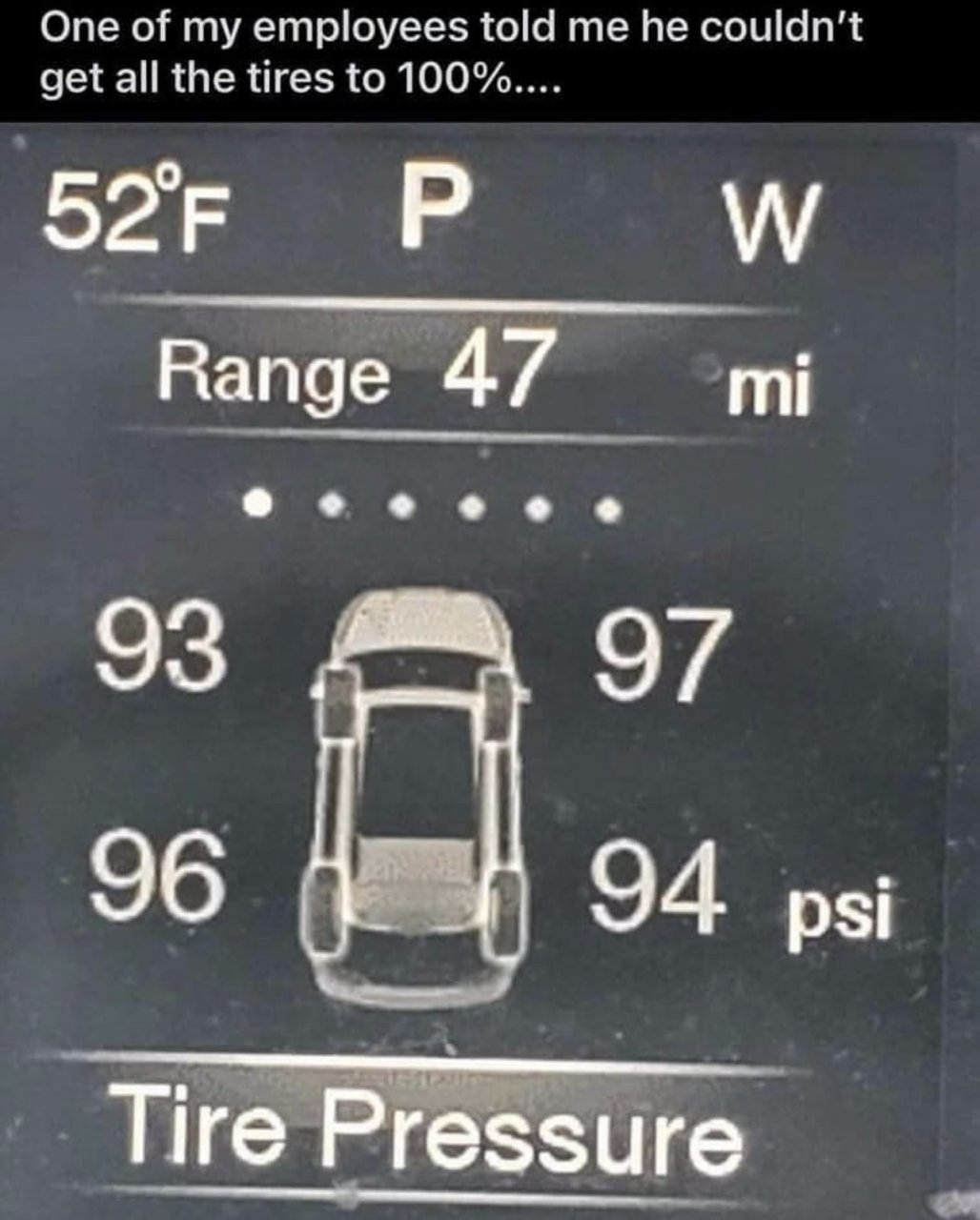

    I'd be more concerned with the amount of fuel he has left at the moment.
