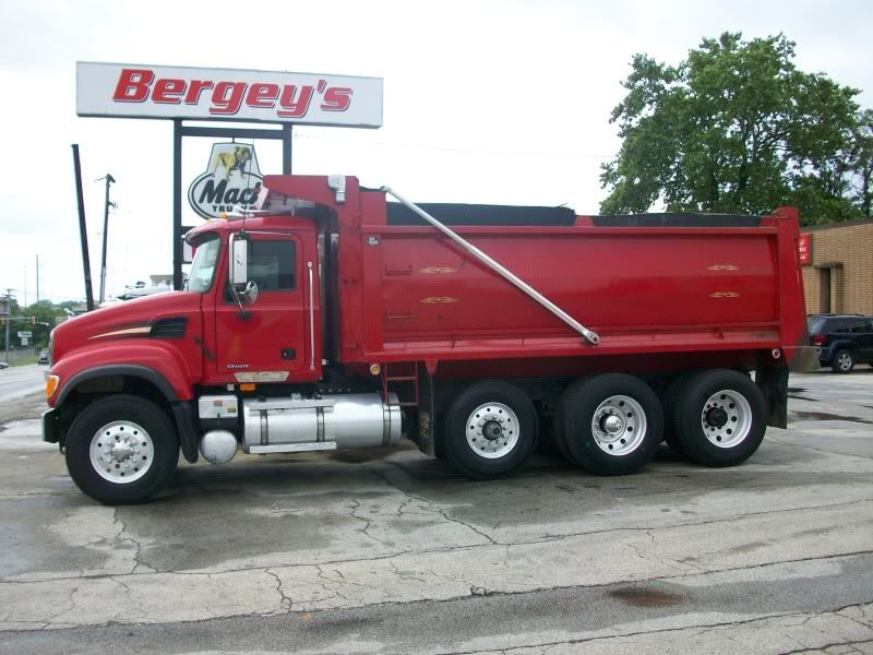

    That looks like my mailbox...even the stain in the driveway matches mine..
    This is what I am looking to do. - My rims currently look like yours DID. What did you do?
